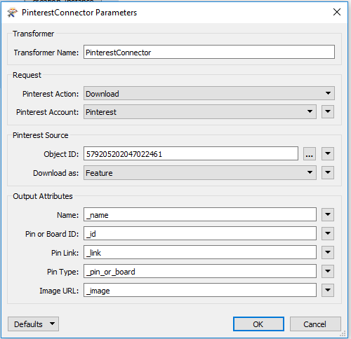

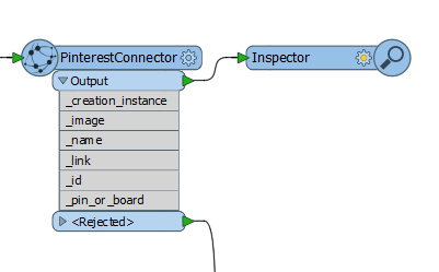

In this example, the PinterestConnector is used to download a Pin as a feature from Pinterest. After creating a valid web connection to a Pinterest account (which can be done right in the Pinterest Account parameter), and browsing to a Board, the Object ID is retrieved, and output attribute names are specified.
An Inspector is added to inspect the geometry of the newly downloaded feature. The feature, along with its attributes, will be sent to the Data Inspector to view the Pin’s image and see a table view of the output attributes.

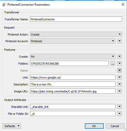

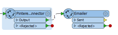

In this example portion of a workspace, the PinterestConnector is used to create a new Pin on a specific Board, it will then be emailed out to users.

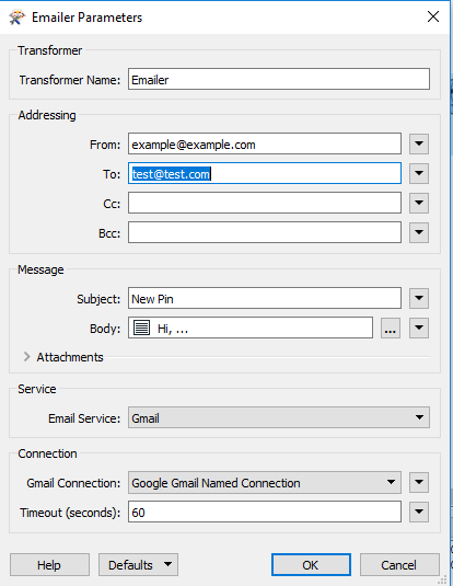

The Pin is created using the PinterestConnector transformer, and filling in the desired information. It is then sent out to the specific users using the Emailer transformer.

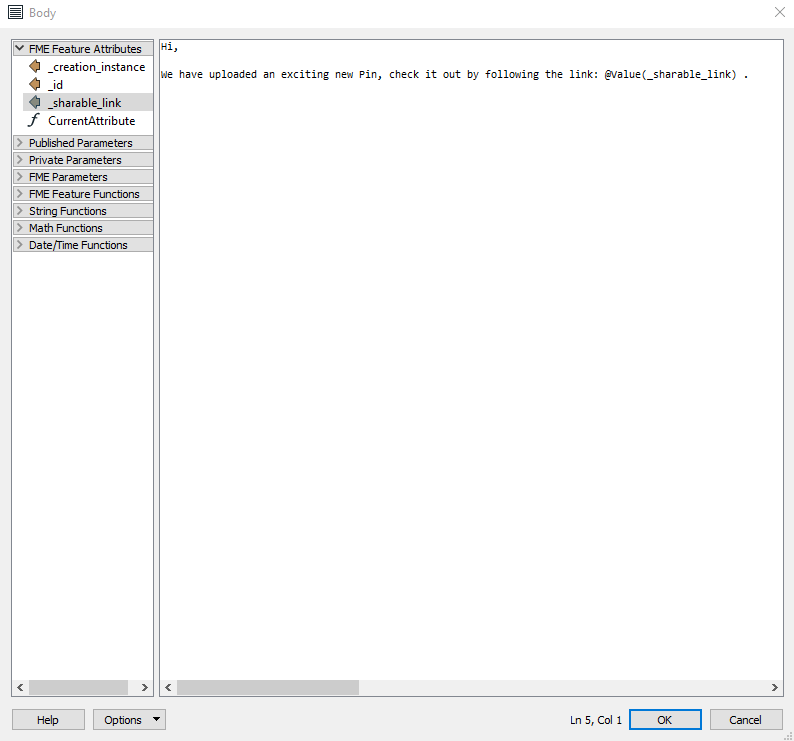

The Emailer transformer will allow the user to send out a message to other users that a new Pin has been created and provides them a link to view it.
To specify the link and message to be sent the user, the body in the message section of the transformer dialog needs to opened and filled out. The shareable link can be inserted by adding it into the message from the “FME Feature Attributes”.
