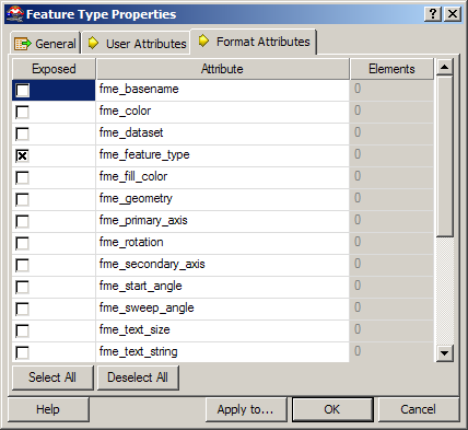

Exposing the fme_feature_type attribute on the original source feature type may be an easier and more reliable way to work with feature types. Click the Properties button on the original feature type, and choose the Format Attributes tab:
