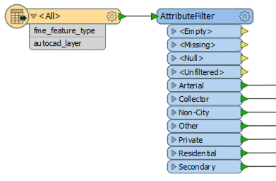

In this beginning of a workspace, a CAD file containing road data is read, and the features divided into separate streams for further processing based on the autocad_layer attribute value.

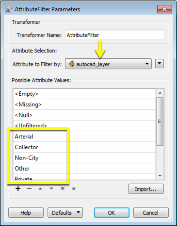

The transformer has been connected to the incoming features from the Reader, and so the dataset’s attributes are available for selection. The autocad_layer attribute is chosen.
The desired values are entered, each on a separate row. The available values could also be determined by using the Import button to scan the contents of the dataset.
