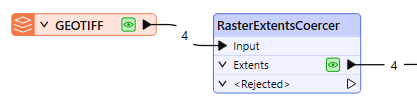

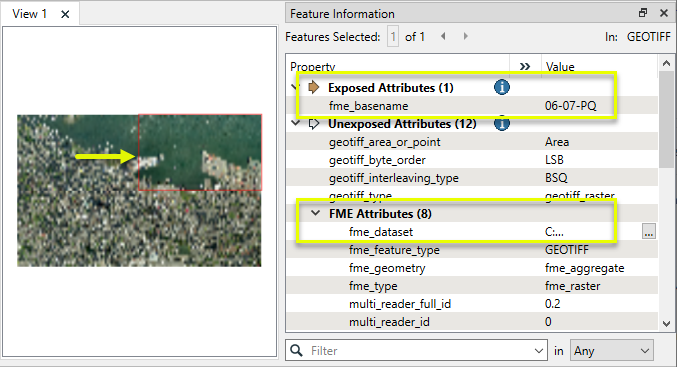

In this example, we will create a polygon index for a set of four adjacent orthophotos. Note that the source rasters’ attributes include a basename and file location that identifies the original dataset and shows where to find it.
The rasters are routed into a RasterExtentsCoercer.

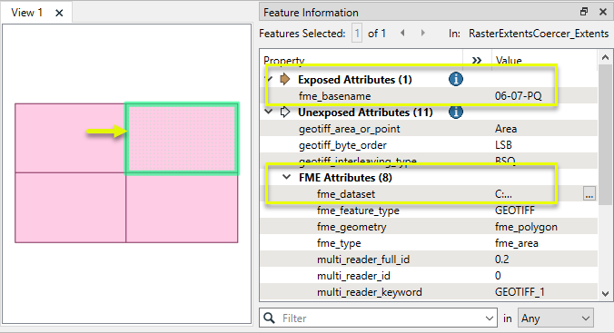

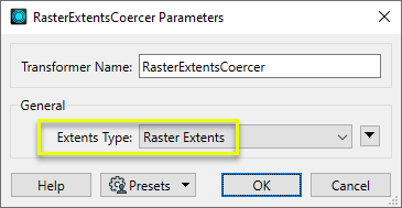

In the parameters dialog, Extents Type is set to Raster Extents.
Four polygons are output, each one representing the entire footprint of one of the input rasters. Note that the polygons receive the original raster attributes.
This data could be written out to a spatial vector format, or non-spatial format such as an Excel spreadsheet, to record which raster tiles are available.

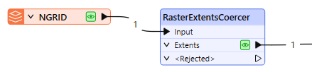

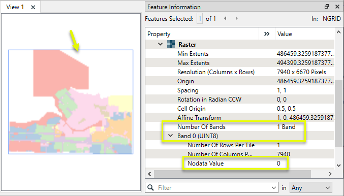

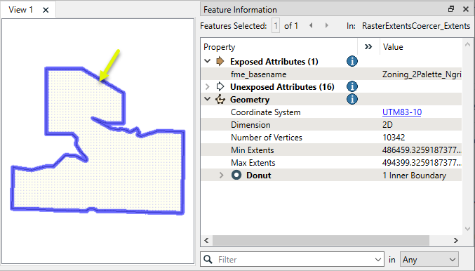

In this example, we will create a polygon that covers all of the cells in a numeric raster that have valid data.
The source raster represents zoning areas, and has one band (with palettes), with a specified Nodata Value of zero (0).

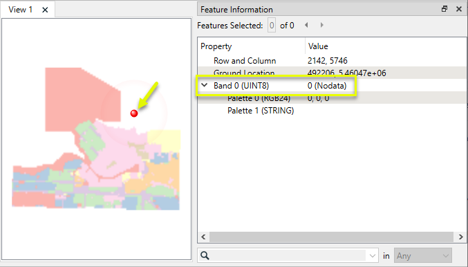

Cells that fall within the rectangular extents of the raster but outside the zoning coverage have a value of zero (0), and are considered Nodata.
The raster is routed into a RasterExtentsCoercer.

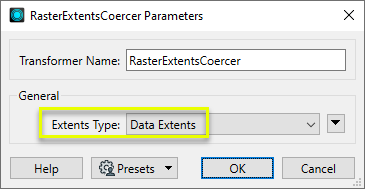

In the parameters dialog, Extents Type is set to Data Extents.
The output polygon encompasses all cells with valid data.

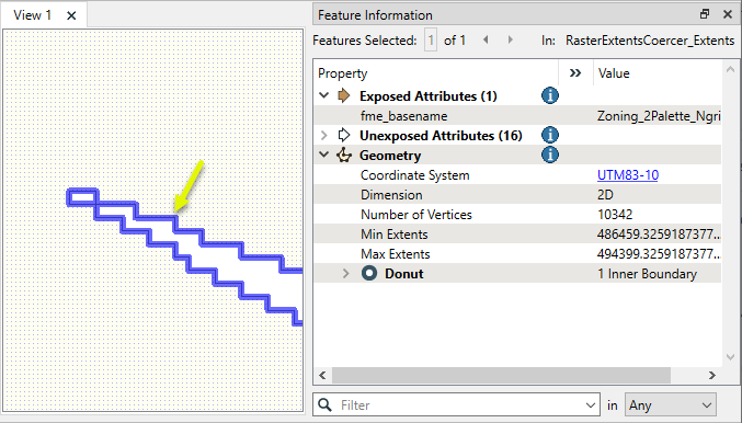

The polygon traces the cell boundaries.

Extents Type |
Select the type of polygon to generate. Raster Extents: The polygon covers the entire extents of the raster. If the raster is rotated, the rotated corners of the raster are used for the polygon. This is the simplest and quickest of the different types. Data MBR Extents and Data Extents: These modes examine the data in the raster to more accurately determine the extents. A cell is considered to be Nodata when, for each selected band, the value for that cell is equal to that band's Nodata value. If any cell value is not equal to that band's Nodata value, the cell will be considered data. In these modes, this transformer will only operate on selected raster bands, and each selected band is required to have a Nodata value. In Data MBR Extents mode, the polygon will be an axis-aligned bounding rectangle that covers all data cells in the raster. This is more computationally expensive than finding the Raster Extents. In Data Extents mode, the output geometry will be either a single polygon or an aggregate of polygons that exactly cover only the data cells in the raster. This is more computationally expensive than finding the Data MBR Extents. |
