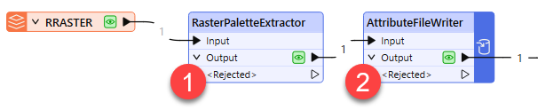

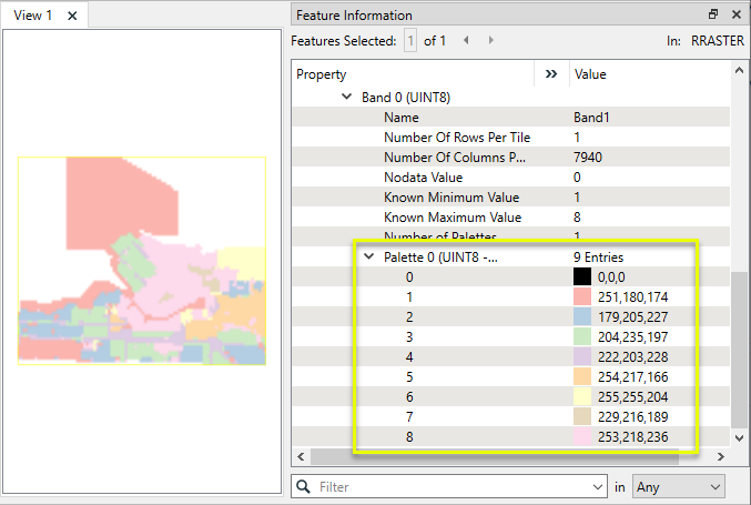

In this example, we will extract a palette and write it to a text file. Note that the source raster has one palette, and so a RasterSelector is not needed.
Two steps are required:
- Extract the palette to an attribute.
- Write the contents of that attribute to a file.

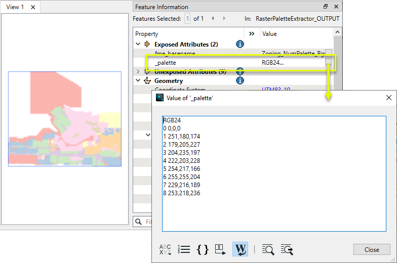

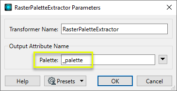

The raster is first routed into a RasterPaletteExtractor. In the parameters dialog, thePalette attribute is given the name _palette.
As the raster feature exits this transformer, the palette has been added to it in string attribute form. The original palette remains intact.

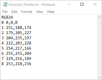

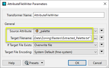

The feature is now routed into an AttributeFileWriter. In the parameters dialog, Source Attribute is set to _palette, and a path and file name are designated for the text file to be written.
The resulting text file contains the palette.
