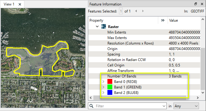

In this example, we will clip an RGB orthoimage to the irregular shape of a park polygon. Note the shape of the park, and that the raster to be clipped has three bands - RED8, GREEN8, and BLUE8.

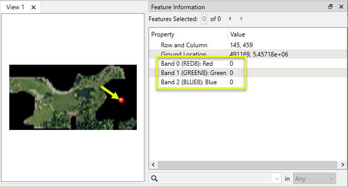

Clipping without adding an alpha band
When the raster is clipped, cells that fall outside the clip boundary but are inside the rectangular bounds of the raster extent are set to zero (0) in all bands. Without an alpha band, these appear as black in the FME Data Inspector.

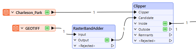

The park polygon is routed into the Clipper input port of a Clipper transformer. The orthoimage is routed first into a RasterBandAdder, and then on to the Clipper’s Clippee input port.

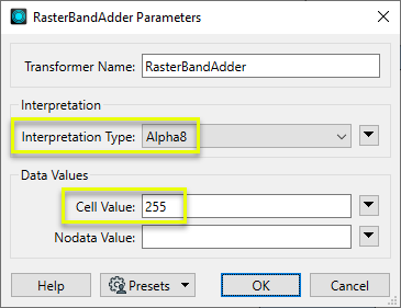

In the parameters dialog, Interpretation Type is to Alpha8. Note that both Alpha8 and Alpha16 are available. Since the Red, Green, and Blue bands are all 8-bit, the alpha band bit depth should match.
For cell value, we enter 255 - the maximum possible value in an 8-bit band. The possible values range from 0 to 255, where 0 is fully transparent, and 255 is fully opaque. At this point, we want the entire image to be visible (fully opaque).

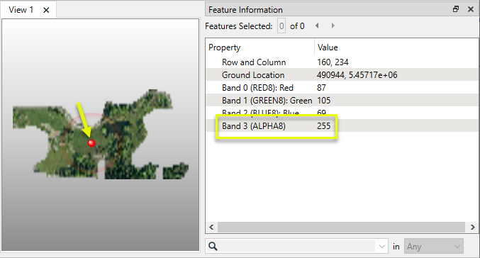

Once the raster with the new alpha band is clipped to the irregular park polygon, cells outside the park boundary have a value of 0 on all four bands. Because the newly added alpha band is also 0, that part of the image becomes transparent.
Cells inside the park boundary retain their original values, and the alpha values remain 255 - fully opaque.
