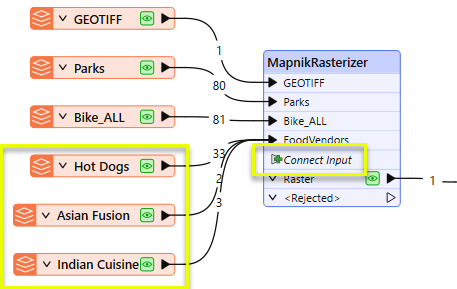

All source datasets are routed into a MapnikRasterizer. creating new input ports when required by connecting to the Connect Input port. Note that all three of the food vendor datasets are connected to the same port - they are all point geometry, and will all be styled the same way.

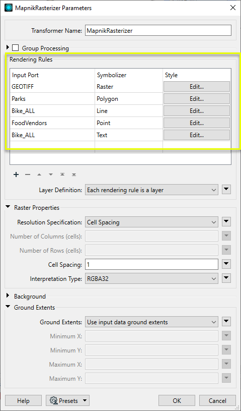

In the parameters dialog, we set the output raster size to be based on one (1) meter pixels (cells), and construct the Rendering Rules table.
Note the following choices:

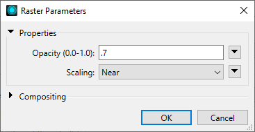

GEOTIFF (the orthophoto) goes first, to provide a background for the output raster. It is styled with a Raster symbolizer. Opacity is set to .7, to fade the image a bit and allow the rest of the features stand out. |

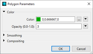

Parks are next, styled with a Polygon symbolizer. They are filled green, and Opacity set to .5. If we wanted to draw a contrasting border around the parks, we would duplicate the rule, and use a Line symbolizer to style the border. |

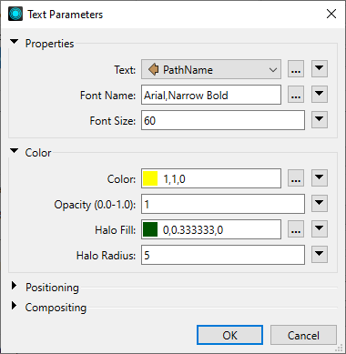

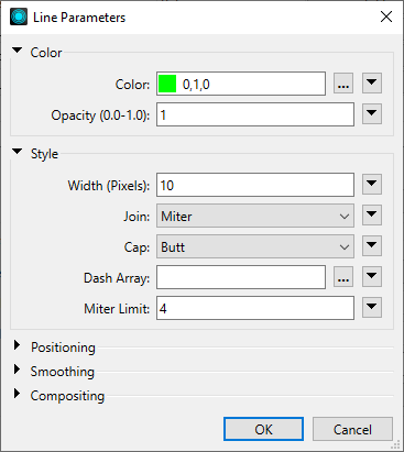

Bike_ALL contains the bike paths, with attributes. We have created two rules for them (using the copy and paste tools below the table) - note that they do not appear together in the table, and are separated by the FoodVendors layer. The first rule styles the lines, and the second performs labeling. Food vendor symbols may overlap the lines, but will appear behind any bike path labels they may collide with. To generate the labels, we select the PathName attribute. The Halo Fill parameter produces a glow behind the letters, making them more visible against the background and other features. |
Line styling:
Labeling:

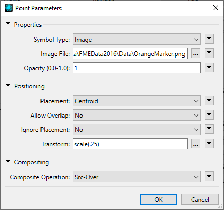

FoodVendors contains all three of the point datasets attached to this input port. Renaming a port in the Rendering Rules table is reflected in the transformer itself - this port was created when Hot Dogs was attached to Connect Input, and then renamed in here. This layer is styled with a Point symbolizer. By choosing Symbol Type, Image, we can select a symbol raster to be used - in this case, an orange marker that has been saved as a PNG file with a transparent background. The symbol was scaled to the appropriate size by using the Transform parameter, scale(.25). |
OrangeMarker.png has a transparent background:

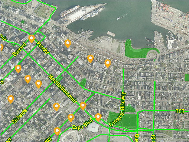

The raster is produced according to the parameter selections.
