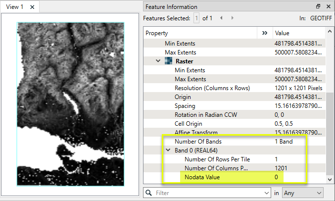

In this example, we want to remove the Nodata value from a numeric raster that contains slope values calculated from an elevation model.
Note that the source raster has one band, and its Nodata Value is zero (0). As a result, cells with no slope (value of zero) are not displayed, making flat surfaces such as water bodies transparent.

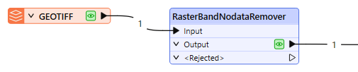

The raster feature is routed into a RasterBandNodataRemover.

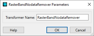

The transformer has no parameters to configure.

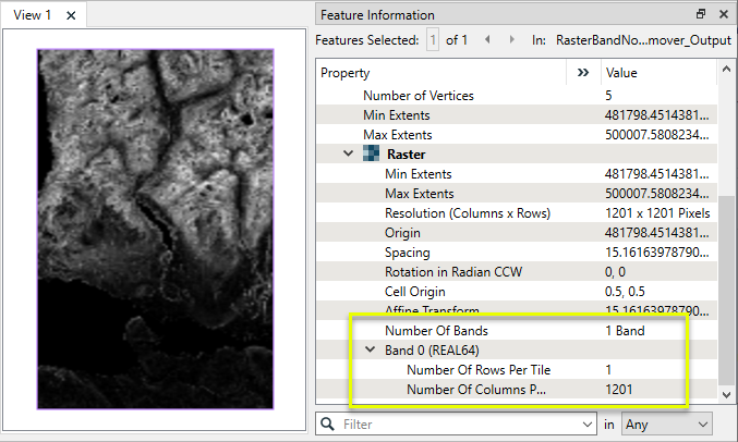

The output raster no longer has a Nodata Value band property. Any cells that had the original Nodata value - zero (0) - still have that value, but they are now considered valid and are displayed.
