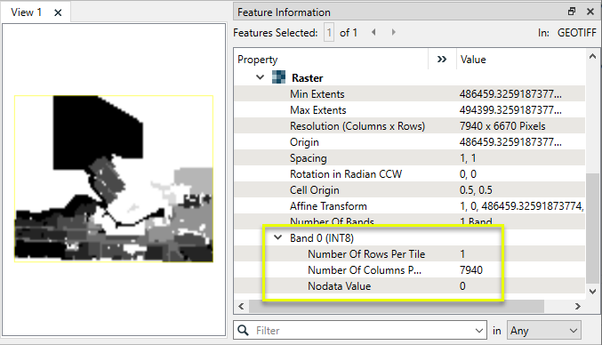

In this example, we will add a color palette to a single-band numeric raster. The original raster has cells with values ranging from 0 to 8, with 0 being the Nodata Value. Note that the band’s interpretation type is INT8, and it has no palettes.

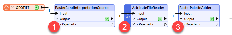

To add the palette, three steps are required:
- Change the band interpretation to a type compatible with palettes.
- Read the palette text file, and assign it to an attribute.
- Add the palette to the raster.

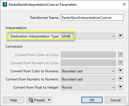

The raster is first routed into a RasterBandInterpretationCoercer. In the parameters dialog, Destination Interpretation Type is set to UInt8, which is compatible with palettes and accepts values between 0 and 255.

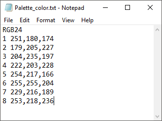

A palette has been prepared, using a text editor.

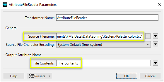

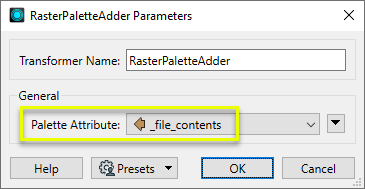

The next step is to read the palette file and assign it to an attribute, using an AttributeFileReader. In the parameters dialog, the File Contents attribute will store the contents of the file, and is named _file_contents.
The final step is the RasterPaletteAdder. In the parameters dialog, Palette Attribute is set to _file_contents, which will retrieve the palette from that attribute and apply it to the raster.

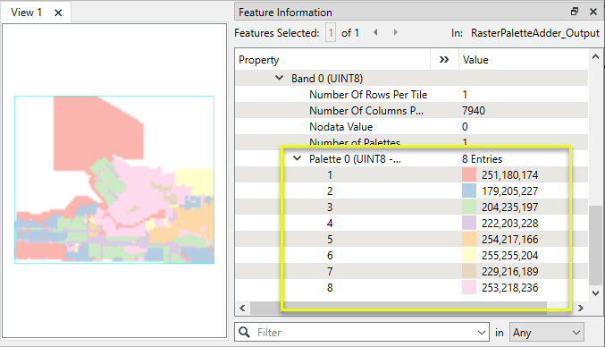

The output raster feature has one band, interpretation type UINT8, and the palette is attached and rendered by the FME Data Inspector.
