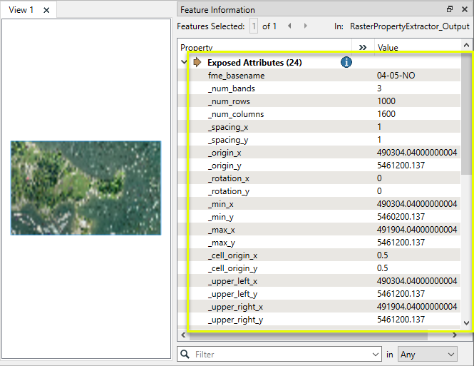

Property attributes include:
_num_bands
_num_rows
_num_columns
_spacing_x
_spacing_y
_origin_x
_origin_y
_rotation_x
_rotation_y
_min_x
_min_y
_max_x
_max_y
_cell_origin_x
_cell_origin_y
_upper_left_x
_upper_left_y
_upper_right_x
_upper_right_y
_lower_right_x
_lower_right_y
_lower_left_x_lower_left_y

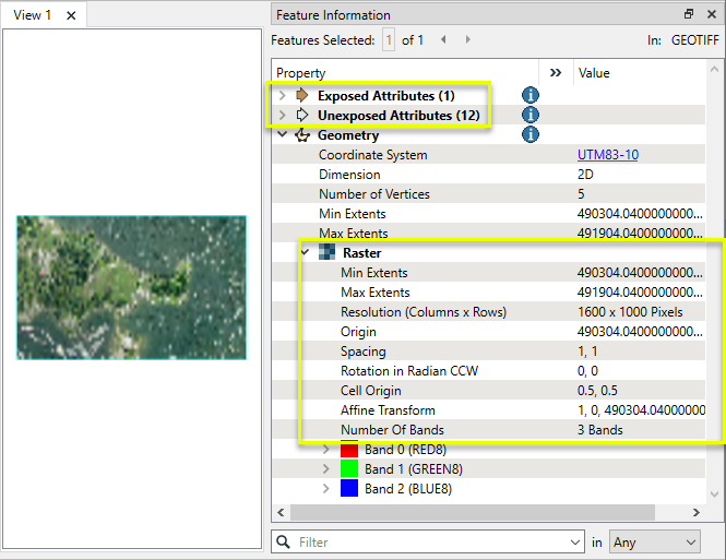

In this example, we will extract the geometry properties of an orthoimage. Note that the source raster feature has 13 typical attributes. Some geometry properties can be seen in the Feature Information window of the FME Data Inspector (under IFMERaster), but are not exposed in a usable attribute form.

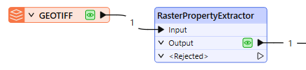

The raster is routed into a RasterPropertyExtractor.
There are no parameter settings in this transformer. The raster is output, with new attributes exposed containing properties.
