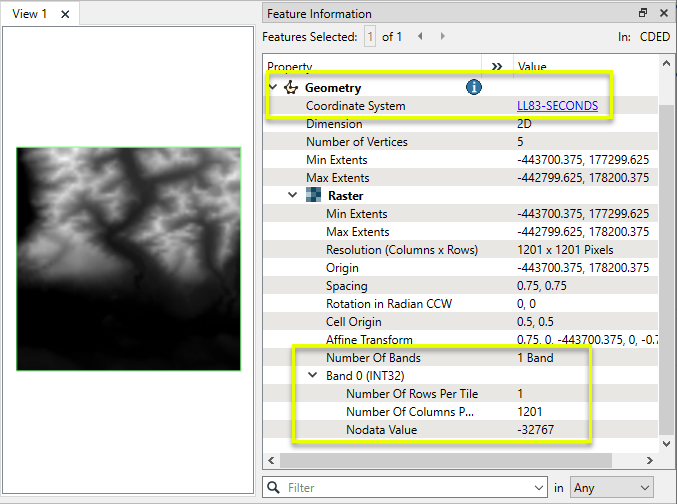

In this example, we will generate a hillshade representation of a Digital Elevation Model (DEM). The source data ranges in elevation from sea level (0) to around 1500 meters, in a mountainous area.
Note that elevation is stored in Band 0, as 32-bit integer, and that it does have a Nodata Value set.

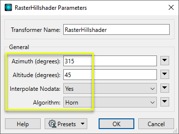

In the parameters dialog, we will keep the default settings. They include the light source’s Azimuth of 315 degrees and Altitude of 45 degrees, which are commonly used values. Interpolate Nodata is set to Yes, and the Algorithm is Horn.

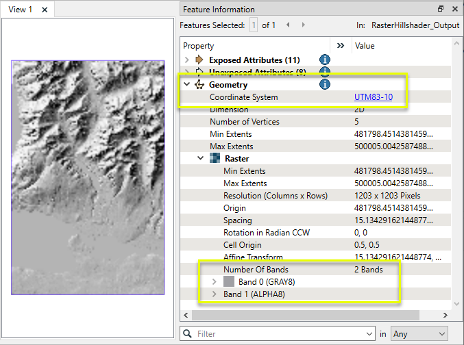

The output raster has two bands. Hillshade values (0 to 255) are in the GRAY8 band. The ALPHA8 band represents the Nodata values of the original elevation raster.
Note the shape of the output raster compared to the original DEM data - a result of the reprojection.
