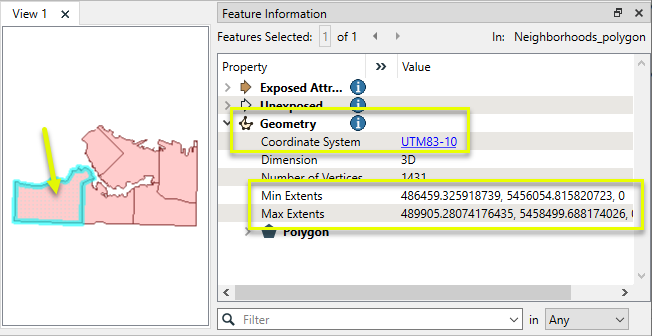

In this example, we have a set of neighborhood polygons. Note that the coordinate system is known, UTM83-10, and the extents are provided in meters.

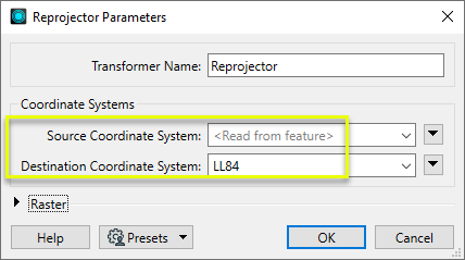

In the parameters dialog, we leave Source Coordinate System as its default, Read from feature. The Destination Coordinate System is set to LL84.

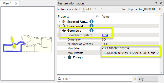

The output features have been reprojected.
