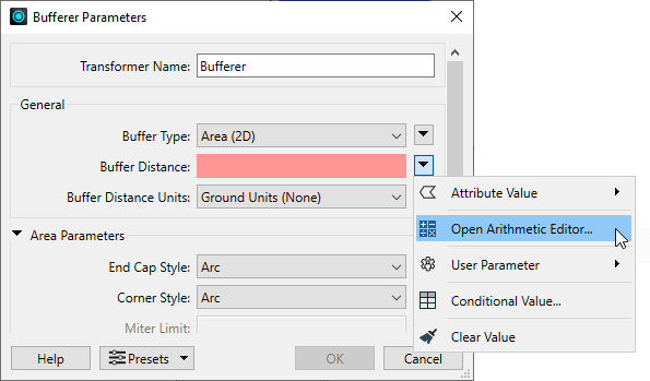

In this example, the source data has a vehicle speed attribute for each point. The data is converted into point features, and the individual buffers are then merged into a single area feature. You want to show areas where vehicle speed is low, to indicate traffic congestion zones.
By using the Arithmetic Editor, you can directly attach the calculation to the Buffer Amount parameter:

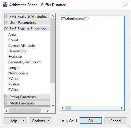

Using the Arithmetic Editor, you can create a buffer around each point, where buffer radius = speed * 4:

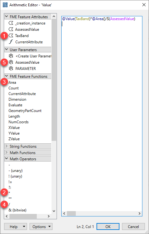

Similarly, in the AttributeCreator transformer, you could create an attribute such as a property’s Taxable Value using an expression such as (@Value(TaxBand) * @Area())/$(AssessedValue).
The numbers 1-5 show the order in which the elements were added to the editor:
Attributes
After the transformer is connected in the workspace, this section lists the available attributes. You can use attributes to supply a value for use within the arithmetic expression.
User Parameters
This is a list of the user parameters (if any) that are in the workspace. You can use user parameters to supply a value within the arithmetic expression.
FME Parameters
In some scenarios, FME Parameters may be useful in the workspace.
FME Feature Functions
These functions are capable of returning a numeric value, which is substituted into the arithmetic expression where defined.
For more information, see FME Feature Functions.
Math Functions/Math Operators
For more information, see Math Functions and Math Operators.
