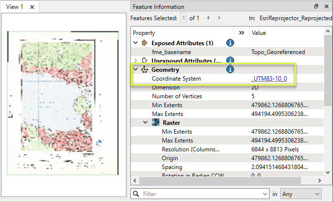

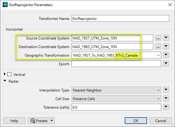

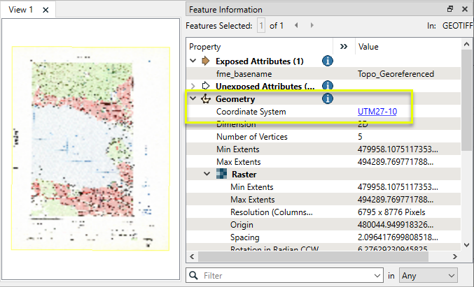

In this example, we have a scanned topo map, georeferenced to UTM zone 10, NAD 27. We want to reproject it to NAD 83.
The raster is routed into an EsriReprojector.
In the parameters dialog, appropriate source and destination coordinate systems are selected. Note that this combination of source and destination has several possible Geographic Transformation choices. As the topo is located in Canada, we select the NTv2 Canada option.
Raster settings are left as default.
The output raster has been reprojected.
