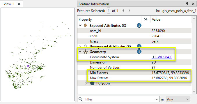

In this example, we have a shapefile of point of interest (POIs) in Sweden, extracted from OpenStreetMap. Note that its Coordinate System is lat/long, WGS84.

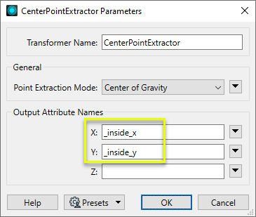

We want to do two things - first, extract the center coordinates of each feature into attributes, and then reproject those attributes into an appropriate national coordinate system using the Gtrans engine.
The features are routed into a CenterPointExtractor, and then into a GtransAttributeReprojector.
In the parameters dialog of the CenterPointExtractor, we assign names to the new attributes which will contain the point coordinates.

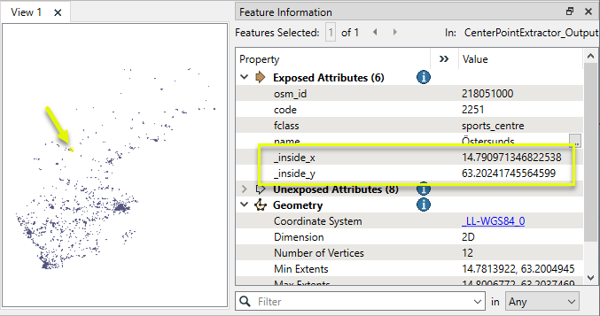

As the features exit the CenterPointExtractor, they have two new attributes containing their extracted coordinates.

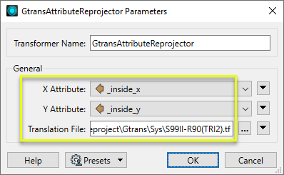

In the parameters dialog of the GtransAttributeReprojector, the X and Y Attributes are set to the values of the newly added coordinate attributes.

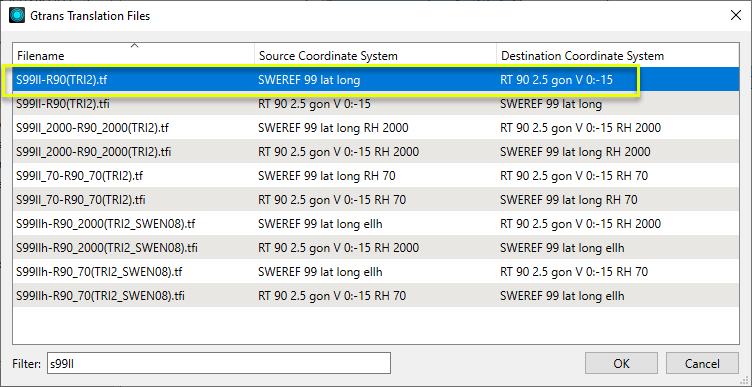

A Translation File is also selected.
The Translation File was selected from the Gtrans Translation Files gallery, via the ellipsis button. Note that the chosen Source Coordinate System is SWEREF 99 lat long, an equivalent to LL-WGS84

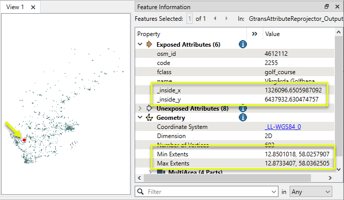

The output features have not been reprojected - but the coordinates stored as attributes have been.
