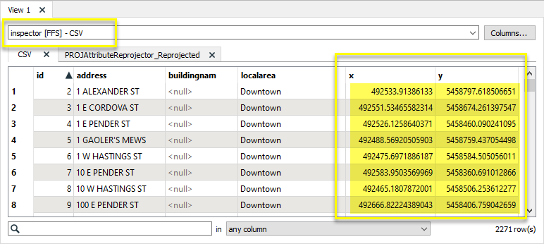

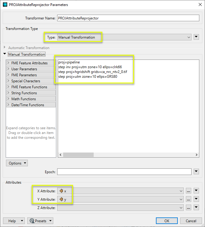

In this example, we start with a CSV file of Historic Sites. It has no geometry, but it does contain coordinates for the sites, with a UTM Zone 10 NAD27 coordinate system. We want to reproject this to NAD83, using PROJ.
The features are routed into a PROJAttributeReprojector.
In the parameters dialog, Transformation Type is set to Manual Transformation.
The required PROJ pipeline string is entered, which references both the source and destination coordinate system definitions and the desired grid shift file.
Both the X and Y Attributes containing the coordinates are identified.
The new coordinates are calculated using the PROJ library, and replace the existing attribute values. The transformer does not create geometry, it only supplies values.

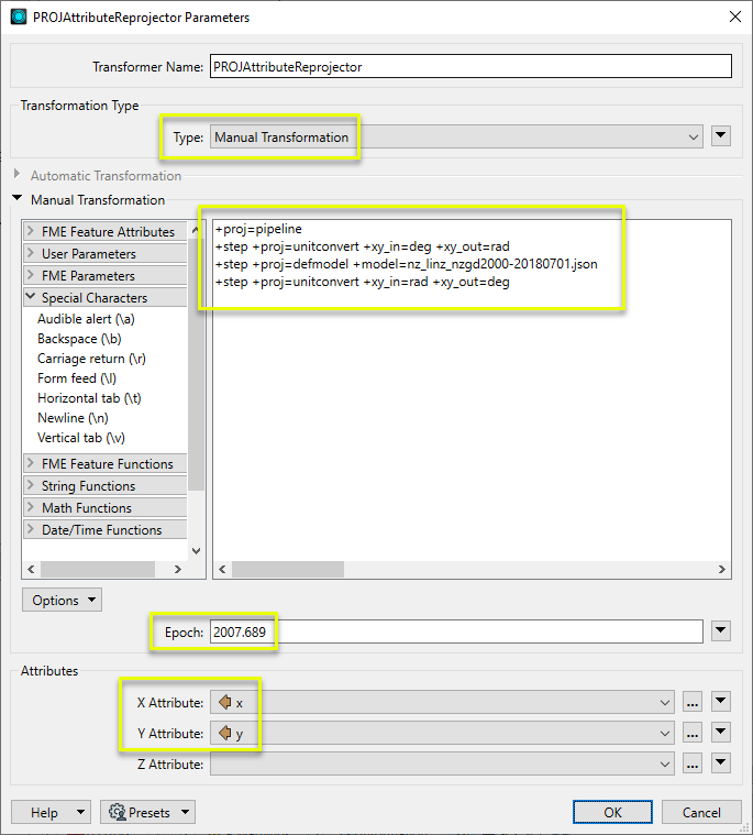

This example shows the PROJAttributeReprojector parameters configured to use an epoch with a PROJ pipeline.
Note that the desired deformation model is referenced in the pipeline string.
Epochs may also be provided via an attribute value or user parameter.
