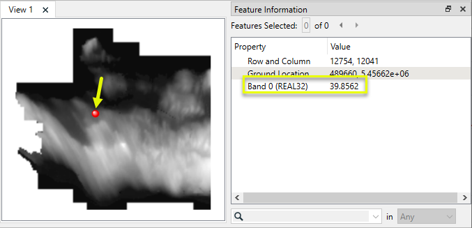

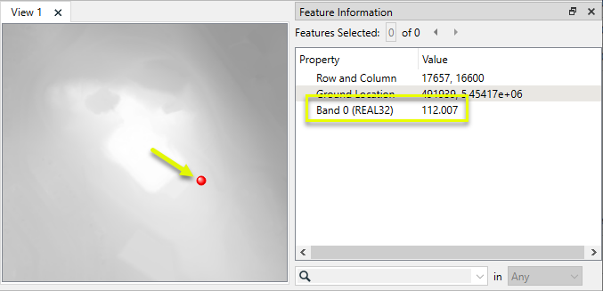

In this example, we have elevations stored in a DEM dataset as Band 0 values, and want to round off these values to two decimal places.

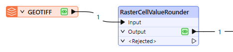

The DEM is routed into a RasterCellValueRounder.

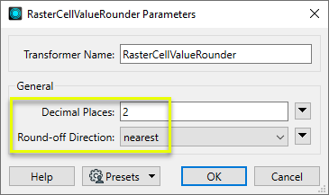

In the parameters dialog, we specify 2 decimal places, and select nearest rounding, which will round up or down as appropriate.
A raster feature is output, with new Band 0 values, rounded to 2 decimal places.

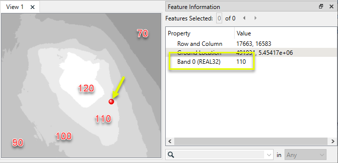

In this example, we will use negative rounding to create 10 meter elevation ranges in a DEM dataset. The elevations are stored as Band 0 values.

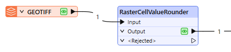

In the parameters dialog, we specify the Decimal Places as -1. This will round to the tens position.
The Round-off Direction is down. This will round all values in a 10 meter range to the starting number - that is, values like 21, 25, and 29 will all be rounded to 20.
A raster feature is output, with new Band 0 values rounded accordingly.
