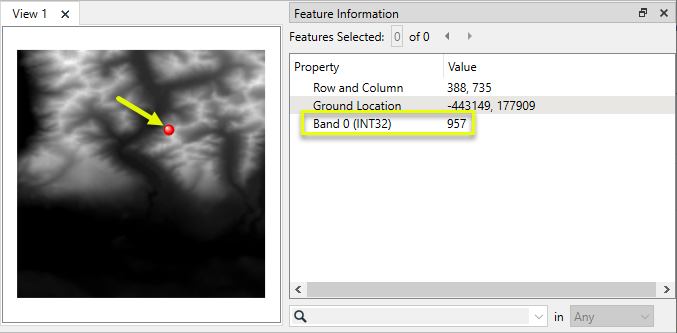

In this example, we will calculate the aspect of each cell in a DEM. Note that the elevation values are stored in Band 0 as integers (in meters).
The DEM is routed into a RasterAspectCalculator.

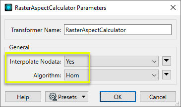

In the parameters dialog, we choose to interpolate Nodata, and use the Horn algorithm.

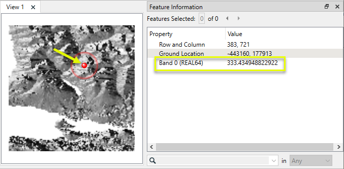

The output raster feature has new Band 0 values - the calculated aspect - and the band has been converted to a floating-point decimal interpretation type (real64).

Interpolate Nodata |
Calculate values at raster edges and near Nodata values. No: When any pixel in the 3x3 window used to calculate the aspect value is equal to Nodata, the output pixel will also be set to Nodata. If the input band does not have a Nodata value, the output band Nodata value will be set to -1. There will be a one pixel border around the edge of the raster set to the Nodata value. Yes: Values around the edge and near Nodata values will be estimated by interpolating missing values. Note that holes will not be filled in - cells that are Nodata in the input raster will remain Nodata in the output. |
Algorithm |
The algorithm used to calculate the aspect. Some analyses have suggested that Horn's formula is better suited to rougher terrain, whereas Zevenbergen & Thorne's formula is better for smooth terrain. |
