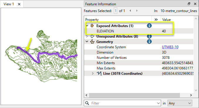

In this example, we will generate a DEM from a set of contour lines, spaced at a ten meter interval. Note that the source data does not have elevation values as a z coordinate - though it is a 3D dataset, the z values are all zero (0).
The elevation values are stored as an attribute named ELEVATION and need to be applied as z values before the DEM is generated.

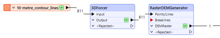

The contours are routed first into a 3DForcer, and then to the RasterDEMGenerator.
In the 3DForcer parameters dialog, Elevation is set to the ELEVATION attribute, and Preserve Existing Z Values is set to No. The attribute values will overwrite the existing z values.

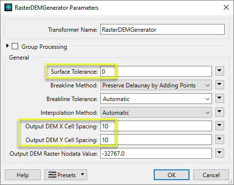

Next, in the RasterDEMGenerator’s parameters dialog, we set Surface Tolerance to zero (0), which means that no vertex filtering will take place, and all points will be considered.
Cell Spacing (both X and Y) is set to 10. The output cells will be 10 meters square, as the source data’s coordinate system is in meters.

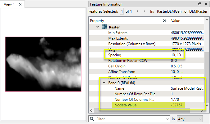

The output DEM raster has a single Real64 band, 10 meter square cells, and the specified Nodata value.
