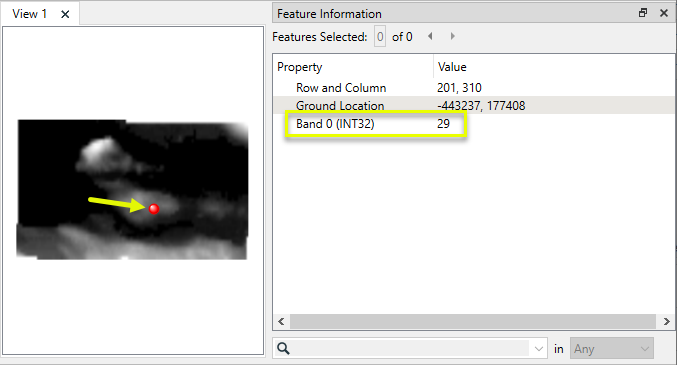

In this example, we will convert a DEM raster to points. The source dataset contains elevation as Band 0 values.

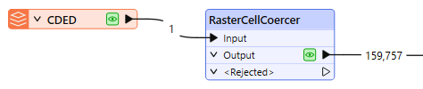

The raster is routed into a RasterCellCoercer.

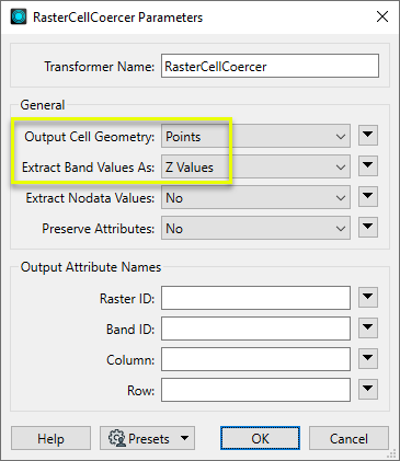

In the parameters dialog, we select Output Cell Geometry as Points, and choose to Extract Band Values as Z Values.
Note that the Output Attribute Names do not have defaults, and so will not be created unless explicitly specified, as they can increase processing time substantially.

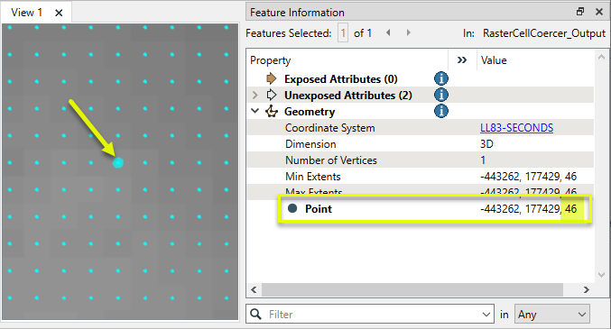

One point is output at the center of every cell, shown here with the original DEM displayed behind the point data. Note that the geometry is 3D, and the selected point has an elevation (z coordinate) of 46.
