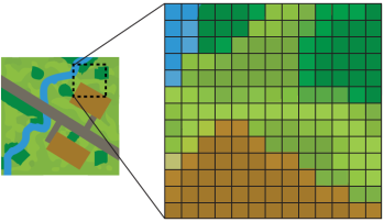

A raster is a rectangular matrix of evenly-spaced cells (sometimes called pixels), arranged in columns and rows.
A raster – and therefore its cells – has one or more bands (sometimes called channels or layers). A band’s interpretation determines what range and type of values it can hold.
Each cell has one numeric value per band.

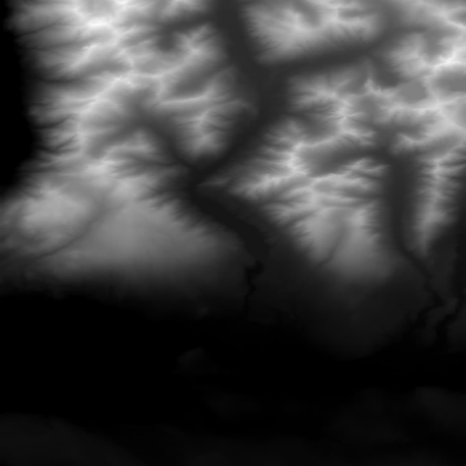

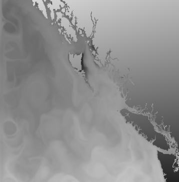

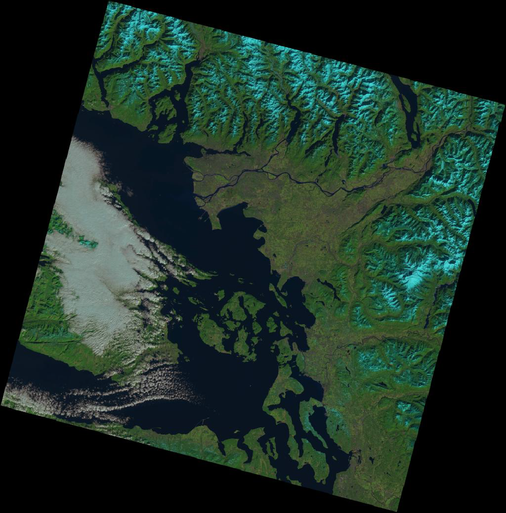

Rasters may represent image or numeric data. Images are commonly derived from satellite data or photography, while numeric data often represents elevations, temperatures, and other quantitative information.
The number of bands will vary – one for a digital elevation model (DEM) or simple numeric raster, three or four for most color image rasters (red, green, blue, and sometimes alpha), and even more for those produced with multiple sensors or representing measurements repeated over time.
Orthoimage
Digital Elevation Model
Numeric
Satellite: Multispectral

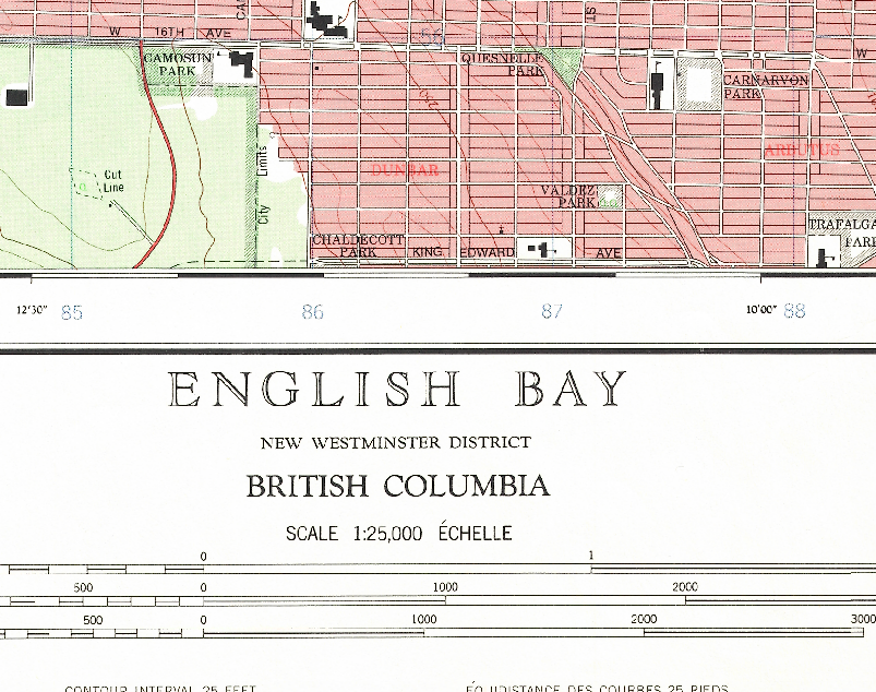

Scanned map
Some rasters are georeferenced, and know where they are positioned on the earth. Some, such as scanned maps, can be manually georeferenced. Some may be tied to a point on the earth (as is a photo with embedded GPS information) but the contents of the image are not georeferenced. Some may be associated with a geographic feature and stored as an attribute, common with scanned documents and images.

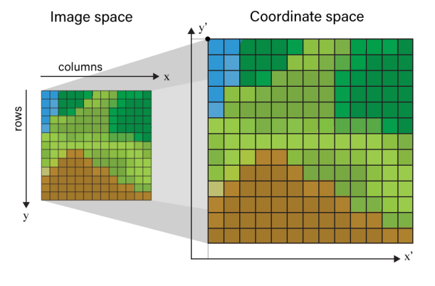

A raster’s origin with regards to its own columns and rows is the upper left corner.
This differs from its geographical extents, which are described from the lower left to upper right corners. If a raster is georeferenced, these corner x and y coordinates will reflect the units of the raster’s coordinate system (meters or degrees, for example).

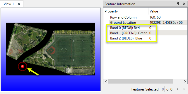

In this example, an irregularly-shaped raster is produced by clipping to a park boundary. Cells that fall outside the park boundary but inside the raster's rectangular extents are black.

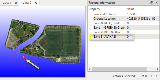

By adding an Alpha band with the value zero (0) in locations that have no data, they are rendered as transparent.

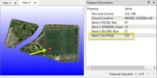

Note that pixels in the Alpha band in locations where there is data – that is, color – have a value of 255, which is fully opaque.

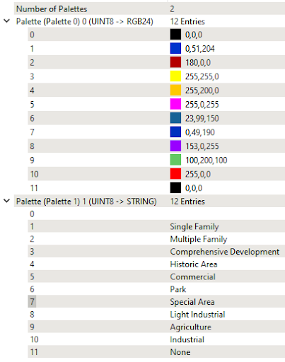

The palette consists of a series of pairs of palette keys and palette values. The palette key is matched to the band’s cell values, and must have the same interpretation type as the band. Bands must be a UInt8, UInt16, or UInt32 interpretation type to have palettes. Palette keys of UInt64 are not supported.
Palette values can be RGB24, RGBA32, RGB48, RGBA64, Gray8, Gray16, or String, as in this example:
