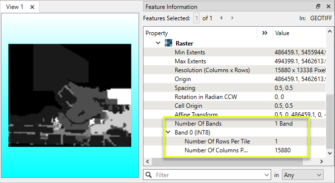

In this example, we have a numeric raster of planning zones, with cell values between 0 and 10 representing the zone type. Zero (0) represents areas that are not included in a valid zone, and so we want to designate those as Nodata, and invalid for calculations.
Note that the original raster does not have a Nodata Value included in band properties.

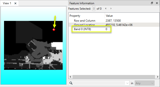

Cells with the value of zero are displayed as black, and are considered valid.

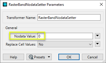

In the parameters dialog, Nodata Value is set to zero (0).
Note that the Replace Cell Values option is not relevant to this workflow, as the incoming raster does not have a Nodata value already set, with existing values to change.

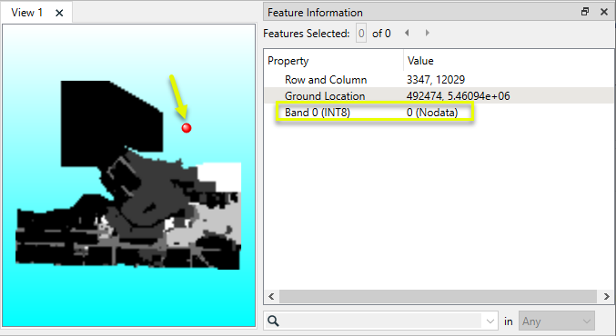

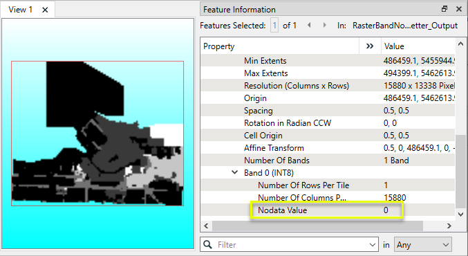

The output raster feature has a Nodata Value band property now, set to zero (0).
Note that the Nodata cells are now rendered as transparent in the FME Data Inspector. The cells still have a value of zero, but are designated Nodata.
