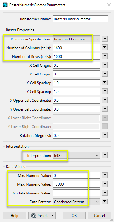

In the parameters dialog, we choose Resolution Specification as Rows and Columns, and specify the size as 1600 by 1000 cells.
An Interpretation of Int32 with Min and Max Numeric Values of 0 to 13000 are appropriate for our test scenario, where the output raster will be a placeholder for a raster DEM. 13,000 is the highest expected elevation for the area.
The Data Pattern for the output raster is Checkered Pattern, which will provide a range of cell values to test against.

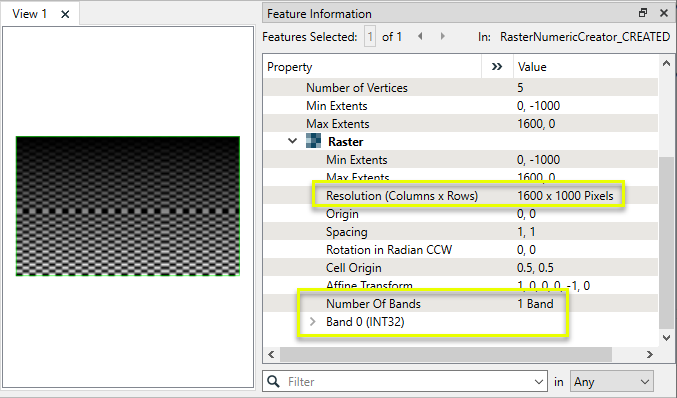

The output raster feature has the specified size, and one INT32 band. It is passed along to the next transformer and can now be used in the workspace.

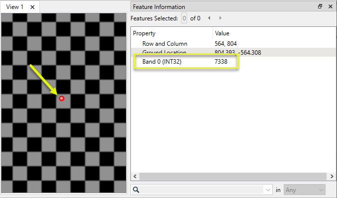

Zooming in closely, the alternating cell values can be seen.
