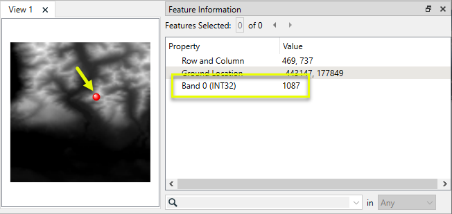

In this example we will perform a slope calculation on a Digital Elevation Model. The source data ranges in elevation from sea level (0) to around 1500 meters, in a mountainous area. Note that elevation is stored in Band 0, as an integer.

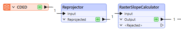

The DEM is routed first into a Reprojector, where it is converted to UTM83-10, an appropriate local coordinate system with ground units in meters, matching the elevation value units. Then it is routed into a RasterSlopeCalculator.

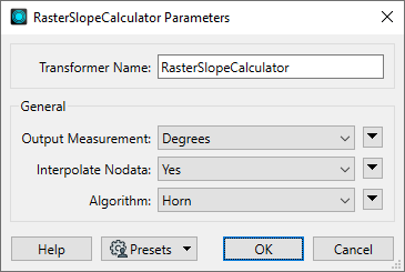

In the parameters dialog, we select an Output Measurement of Degrees, and use the Horn algorithm. Interpolate Nodata is set to Yes.

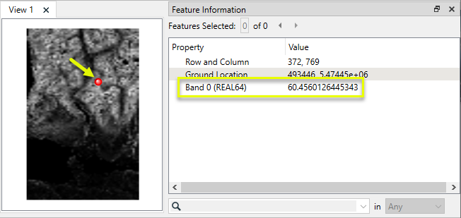

The output raster feature has new Band 0 values - the calculated slope - and the band has been converted to a floating-point decimal interpretation type (real64).
Note the shape of the output raster compared to the original DEM data - a result of the reprojection.
