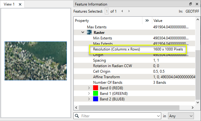

In this example, we will extract a portion of a raster image, and add a frame of empty cells around it. Note that the original image is 1600 x 1000 pixels.

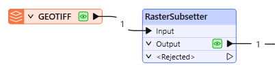

The raster is routed into a RasterSubsetter.

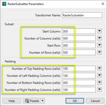

The subset will start at Column 300, Row 300, and will be 500 pixels square. We are also adding cell padding - 100 pixels on the left, top, and right, with a wider 300 pixel padding at the bottom.

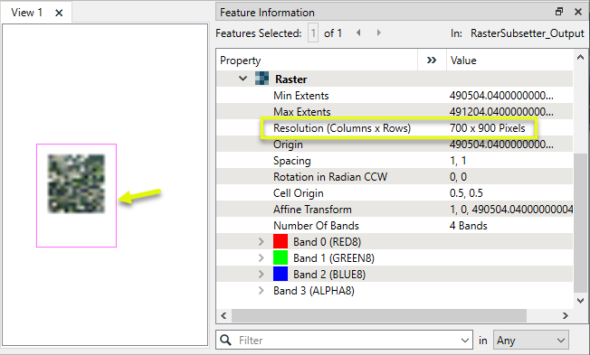

The output feature is the raster subset, including the padding. Note the new dimensions include both the 500 x 500 cropped image, plus the specified padding.

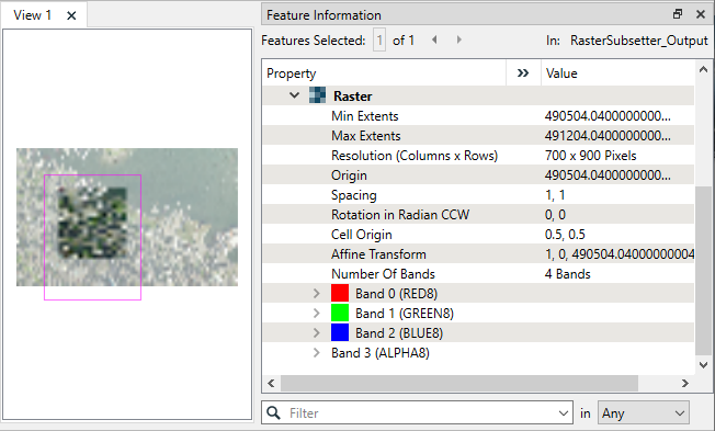

The output raster, including padding, compared to the extents of the original image:

These parameters specify the position and size of the subset, in cells (pixels), to be taken from the raster. They do not include any padding values.
Start Column |
The position of the starting pixel (x-axis) for the subset. Pixels are counted rightwards from the upper left point of origin. |
Number of Columns (cells) |
The number of cells (pixels) to include to the right of the Start Column. |
Start Row |
The position of the starting pixel (y-axis) for the subset. Pixels are counted downwards from the upper left point of origin. |
Number of Rows (cells) |
The number of cells (pixels) to include below the Start Row. |
These parameters specify how many rows and columns of padding in cells should be placed around the subset portion of the raster.
Number of Top Padding Rows (cells) |
The number of cells (pixels) to add above the subset raster. |
Number of Left Padding Columns (cells) |
The number of cells (pixels) to add to the left of the subset raster. |
Number of Bottom Padding Rows (cells) |
The number of cells (pixels) to add below the subset raster. |
Number of Right Padding Columns (cells) |
The number of cells (pixels) to add to the right of the subset raster. |
