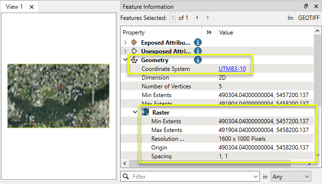

In this example, we will create pyramids for an orthophoto. The source image is 1 meter resolution, at 1600 by 1000 pixels. Note the Min and Max Extents - these will remain unchanged as the image is resampled.

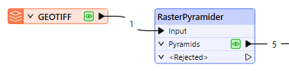

The raster is routed into a RasterPyramider.

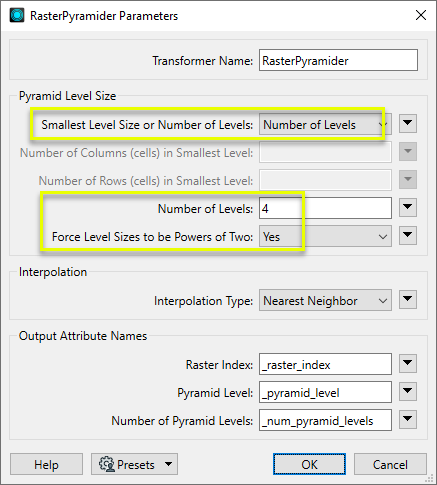

In the parameters dialog, we select Number of Levels as the method, and set that number to 4.
Force Level Sizes to be Powers of Two is set to Yes - this will force raster dimensions to the commonly-used progression of powers of two - see Parameters below for more details on how this works.
Five raster features are output - the original, which is Level 0, plus four new pyramided rasters.

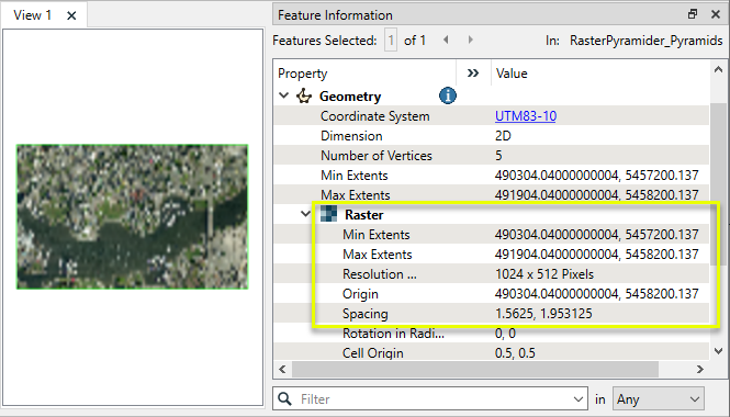

Pyramid Level 1
Pyramid Level 1 is the closest to the original raster, with new dimensions, 1024 by 512, according to the Powers of Two parameter.
Note that the geographic extents are the same as the original - but the pixel size (spacing) and resolution have changed.

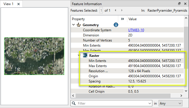

Pyramid Level 4
At Pyramid Level 4, the geographic extents are still the same but the raster itself is much smaller at 128 by 64 pixels.

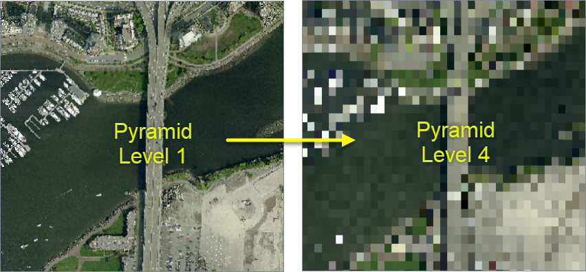

A closer look at the bridge detail clearly illustrates the results of resampling for different levels.

In this example, the source image pixels are 1 meter square (Spacing 1,1). At pyramid level 1, the spacing (pixel size in ground units) becomes 1.5625, 1.93125. The difference in the width and height of the pixel is a result of finding the nearest power of two numbers to scale vertically and horizontally - that is, interpolating 1600 x 1000 to 1024 by 512 within the same geographic extents.
