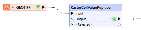

The DEM is routed into a RasterCellValueReplacer.

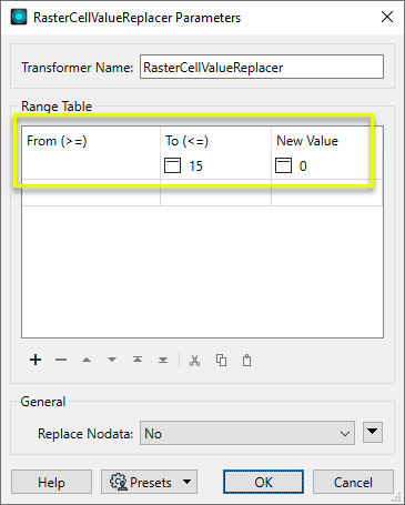

In the parameters dialog, we define a range of values less than or equal to 15. The new value is 0.

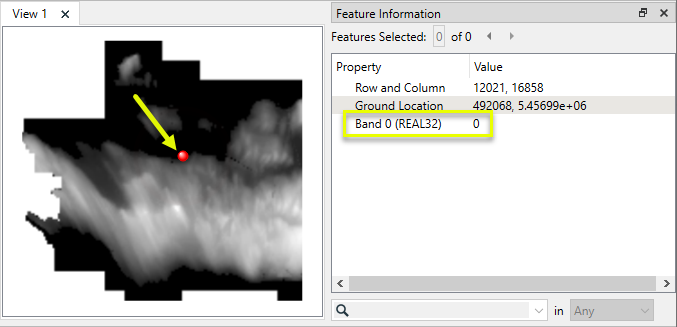

A raster feature is output, and all cells with elevations that fell within the range now have an elevation value of 0.
