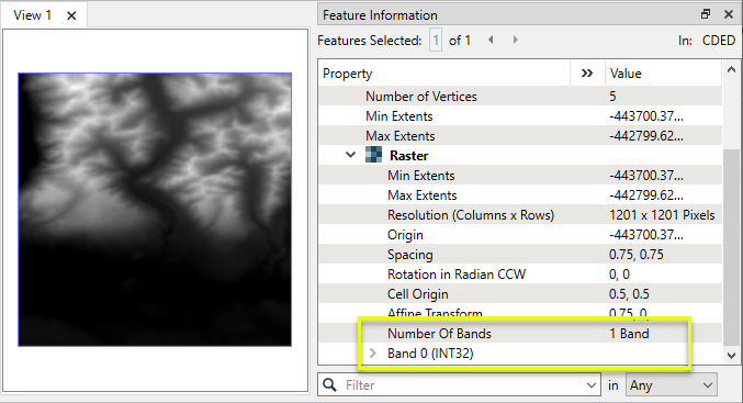

In this example, we will extract the minimum and maximum elevation values from a DEM raster. Note that the original raster feature has one band, containing elevation values in meters.

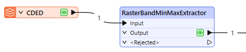

The raster is routed into a RasterBandMinMaxExtractor.

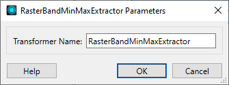

The transformer has no parameters to configure.

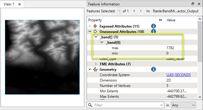

List attributes are added to the output feature, containing the minimum and maximum cell values found on the band. As the raster did not have any palettes, palette-related attributes were not created.
This shows that in this DEM, the elevations range from zero (sea level) to 1,782.
