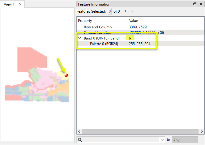

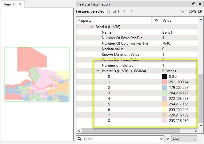

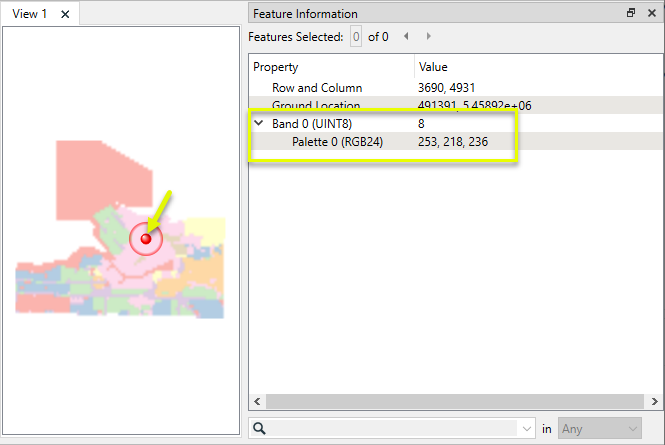

In this example, we have a single-band raster of land use zones, with an RGB palette. We want to remove the palette.
Note that the cell values are palette keys - in this case, a cell value of 6, which the palette associates with an RGB value.

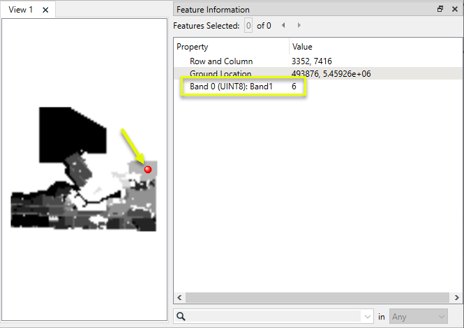

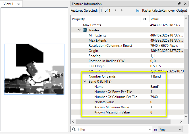

The output raster feature has no palette, and the FME Data Inspector renders it as grayscale.
Note that the cell values are not changed, but the previously associated palette color has been removed.

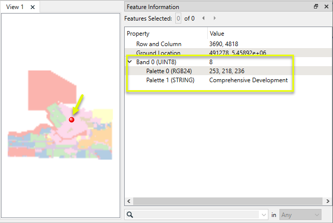

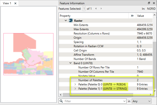

In this example, we start with a single-band raster that has two palettes - one containing RGB colors, and one containing string descriptions. We want to remove the string palette. Note the band and palette numbers - they will be needed to select the correct palette for removal.
Note that the cell values are associated with both an RGB color and a string in the palettes.

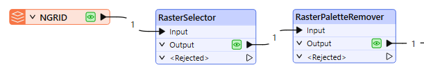

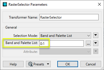

The raster is routed first into a RasterSelector, where we will select the palette to be removed. From there, it is passed through the RasterPaletteRemover.
In the RasterSelector parameters dialog, with the Selection Mode set to Band and Palette List, we define that list as 0 1 - the band and palette numbers identified earlier. This represents the first band (0), and the second palette (1), as band and palette numbering starts at zero.

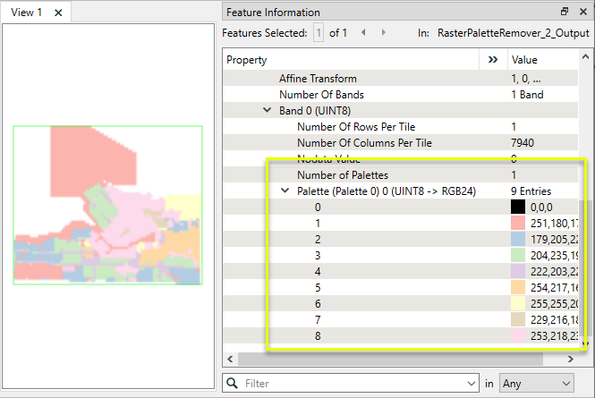

The RasterPaletteRemover has no parameters to configure.
The output raster feature has only one palette - the RGB palette. The string palette has been removed.
Note that the cell values are unchanged, and are still associated with the RGB values from Palette 0.
