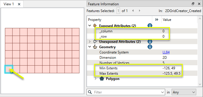

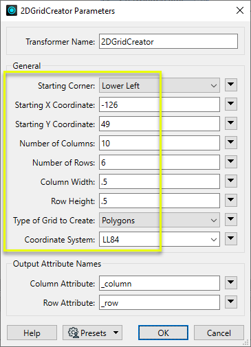

In the parameters dialog, we specify cell size, position, grid extent, and coordinate system. Type of Grid to Create is Polygons.
A grid of rectangular polygons is produced.
Note that the cells are numbered from the selected Starting Corner (Lower Left), starting at 0,0.

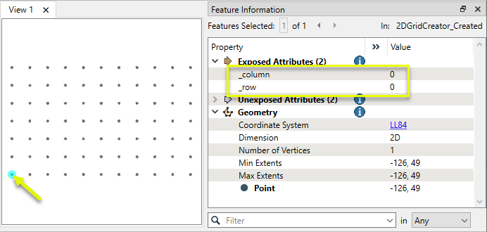

If Type of Grid to Create is Points (Corners), point features are placed at all cell corners.

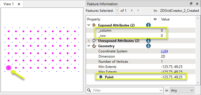

Points (Centers) places a single point at the center of each cell, as shown here in conjunction with the Points (Corners) grid.

Starting Corner |
Select the starting corner for calculating the grid and numbering the columns and rows.
Starting X Coordinate |
Specify the position of the Starting Corner on the x axis. |
Starting Y Coordinate |
Specify the position of the Starting Corner on the y axis. |
Number of Columns |
Specify the number of cells to create horizontally. |
Number of Rows |
Specify the number of cells to create vertically. |
Column Width |
Specify the cell width, in ground units. |
Row Height |
Specify the cell height, in ground units. |
Type of Grid to Create |
Select the grid type:
Coordinate System |
(Optional) Set the coordinate system of the generated grid. |
Column |
Name the attribute to contain column numbers, relative to the Starting Corner. Numbering starts at 0. |
Row |
Name the attribute to contain row numbers, relative to the Starting Corner. Numbering starts at 0. |
