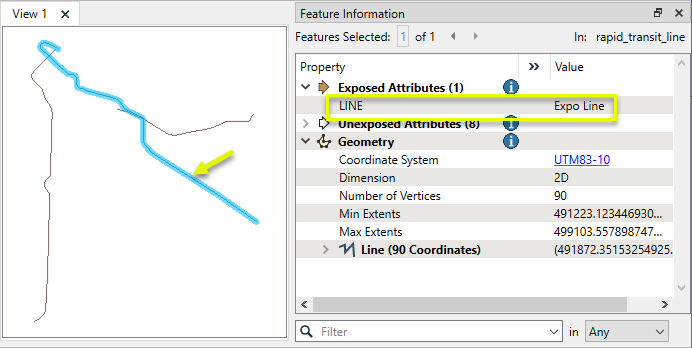

In this example, we will generate two types of 2D bounding boxes for a set of transit line features.
Note that there are three features, with an attribute containing their name.
The features are routed into a BoundingBoxReplacer.

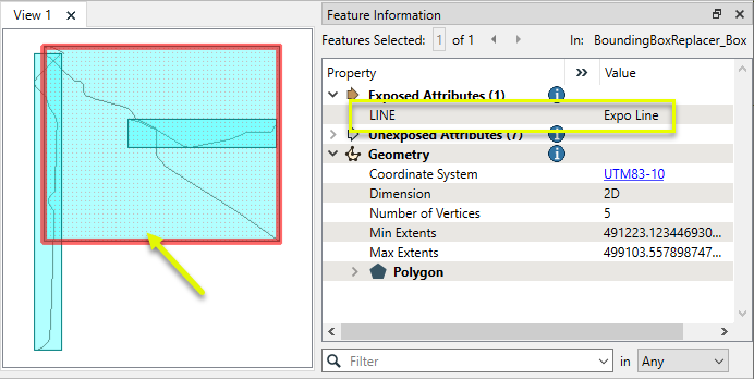

2D Bounding Boxes

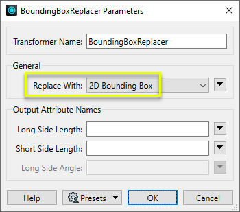

In the parameters dialog, Replace With is set to 2D Bounding Box.
Note that attributes can be created for the bounding box side lengths, but they are not added by default.
The output features have had their geometry replaced by bounding boxes, and the attributes remain intact.

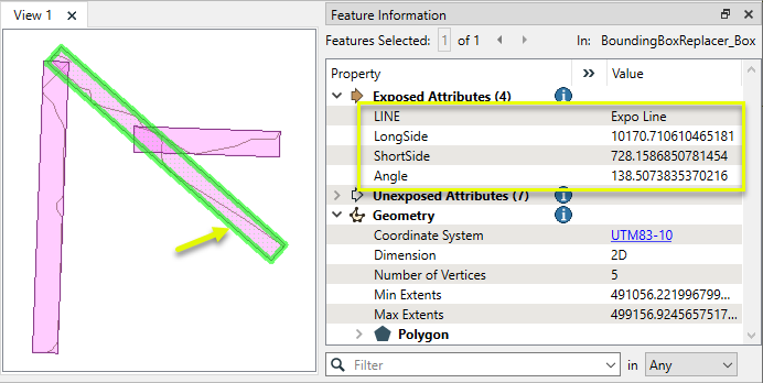

2D Oriented Bounding Boxes

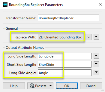

When Replace With is set to 2D Oriented Bounding Box, an additional attribute is enabled to extract the oriented box’s angle.
We supply attribute names for all three.
The output features have their geometry replaced by oriented rectangular bounding boxes.
Their original attributes are intact, with new attributes added containing side lengths and rotation angles.
