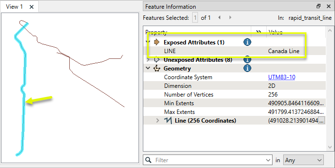

In this example, we have a set of transit line features and wish to extract their bounds as attribute values.
Note that the features have Min and Max Extents values as geometry, but not attributes.
The features are routed into a BoundsExtractor.

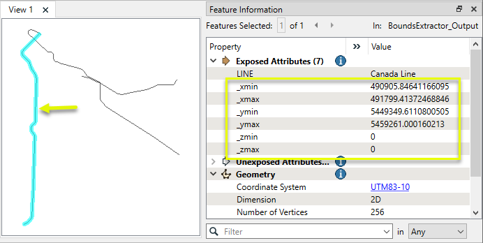

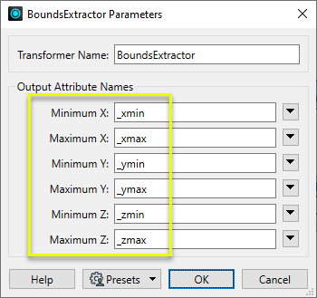

In the parameters dialog, we keep the default attribute names provided.
The output features have new attributes containing the minimum and maximum coordinate values. Note that the features are 2D, and so the z values are zero (0).

Minimum X |
Name the attribute to contain the minimum x value. |
Maximum X |
Name the attribute to contain the maximum x value. |
Minimum Y |
Name the attribute to contain the minimum y value. |
Maximum Y |
Name the attribute to contain the maximum y value. |
Minimum Z |
Name the attribute to contain the minimum z value. |
Maximum Z |
Name the attribute to contain the maximum z value. |
