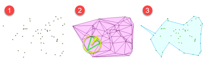

Concave hulls and alpha values
Concave hulls vary in shape. They are calculated by first triangulating the dataset, then measuring the circumradius of the resulting triangles (the radius of a circle that touches all three points of the triangle). Triangles that are larger than the specified Alpha Value are discarded, and the rest are dissolved to form the hull. Measurements are in ground units.
If the Alpha Value is explicitly specified, it is used for the calculation. If it is zero (0) or not specified, the alpha is approximated as the smallest value that produces a single area. If the alpha is too small it may return a null geometry. Larger numbers generally produce larger areas, and a large enough alpha value produces the same result as a convex hull.

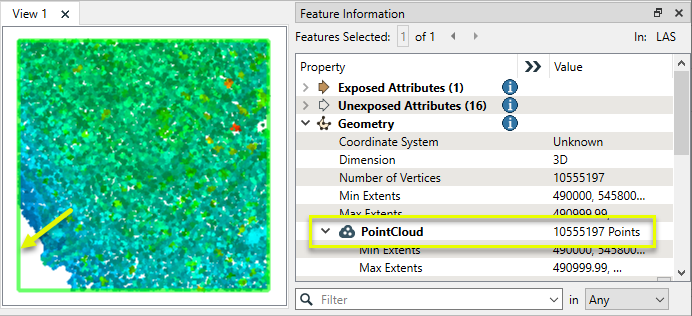

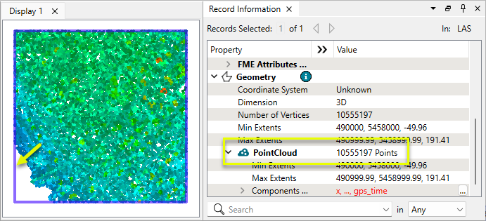

In this example, we want to generate both convex and concave hulls around a point cloud. Note that the bottom left corner of the data has an irregular edge, the result of LiDAR coverage along a coastline.
A point cloud is a single feature. There is a set of specialized point cloud transformers that operate on individual points, but other transformers generally treat their geometry as their rectangular footprint (bounding box).

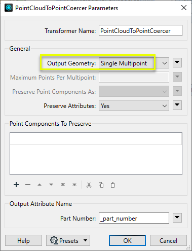

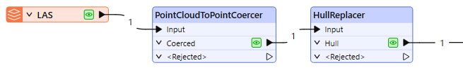

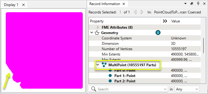

To create a hull that honors the irregular edge, the point cloud is first routed into a PointCloudToPointCoercer and then on to a HullReplacer.

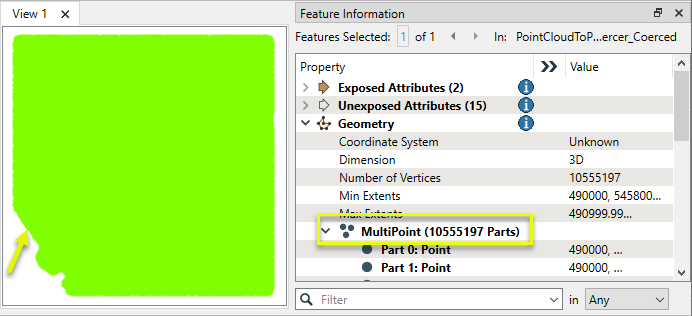

In the parameters dialog, Output Geometry is set to Single Multipoint. Only one feature is output via the Coerced output port.
The resulting multipoint feature is no longer treated as a point cloud. Note that this will result in much longer processing times.

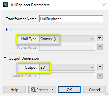

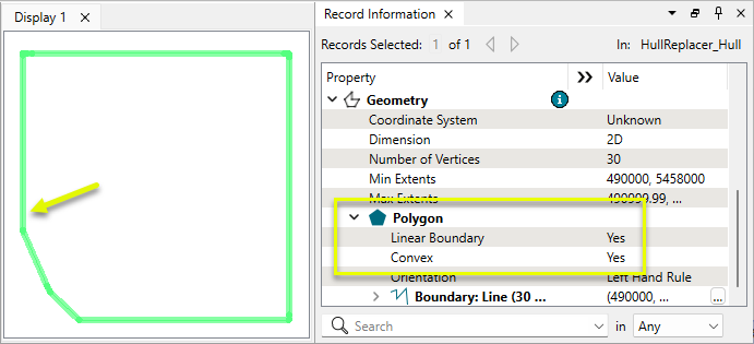

In the parameters dialog of the HullReplacer, Hull Type is set to Convex (), and Output Dimension is changed from Automatic to 2D to ensure the hull is a footprint.

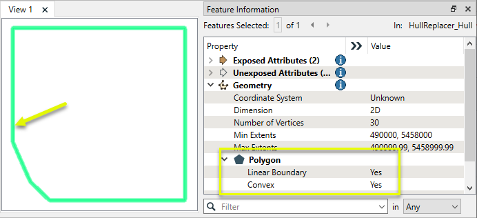

The resulting 2D hull honors the irregular boundary of the data. It replaces the multipoint geometry.

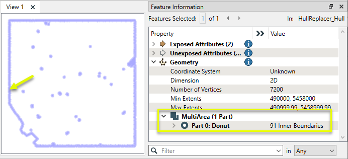

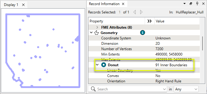

If Hull Type is Concave )( and Alpha Value is left blank (calculating the optimal alpha to produce a single hull), a tightly fitting hull is produced. Processing time is much longer.

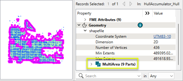

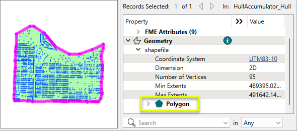

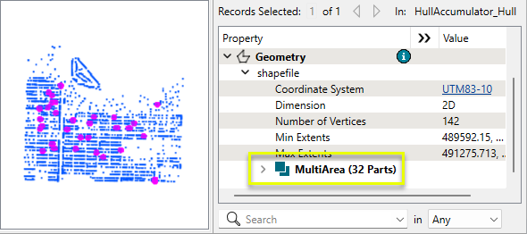

In this example, we will generate a series of concave hulls for a set of property addresses while varying alpha values.
The input features are in a UTM83-10 coordinate system, with ground units in meters, and so the alpha value represents a measurement in meters as well.
Alpha Value |
Concave Hull |
10 - Too small for useful results. |
50 - Tightly fitting, some input points fall outside alpha distance. |

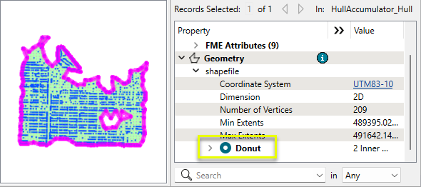

Default (blank) - optimal value calculated to produce a single area. |
500 - Loosely fitting but not convex. |

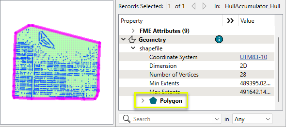

10000 - Identical to the convex hull. |
