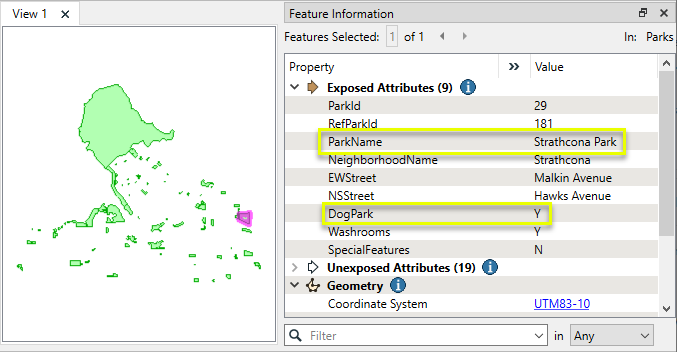

In this example, we have a shape file of city parks. Some of them are dog parks, and we want to write a text file containing all of their names.
Note that the source data has a number of attributes, including DogPark and ParkName.

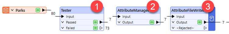

This will take three steps:

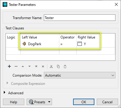

- Use a Tester to identify only the dog parks.

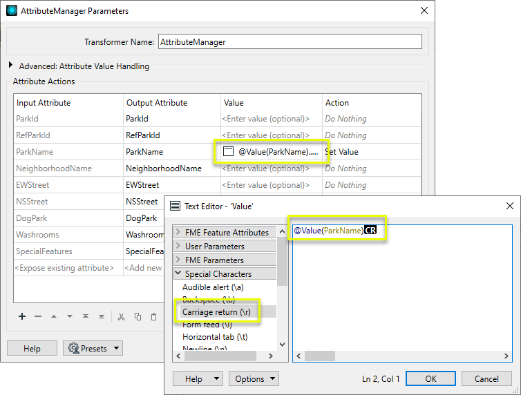

- Add a carriage return to the park name with an AttributeManager.

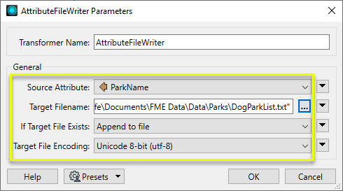

- Write a text file with the AttributeFileWriter.
In the parameters dialog of the Tester, we create one Test Clause, looking for DogPark = Y.
Next, we need to add a carriage return to the end of the attribute so that each one will be written on a separate line.
In the parameters dialog of an AttributeManager, we use the Text Editor to construct an expression that will add the special character to the existing ParkName attribute value.
The final step is to write the text file. In the parameters dialog of the AttributeFileWriter, we choose the ParkName attribute and set a Target Filename.
If Target File Exists is set to Append to file, and a text encoding is chosen.

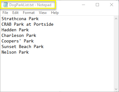

The output file, as examined here in Notepad, contains the dog park names.
A variation on this would be to add <p> tags around each line, with a <br> tag line break, to write the output as very basic HTML.
