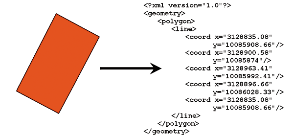

Extracts the geometry of a feature according to the setting of the geometry encoding parameter.
The resulting encoded geometry is added to the feature in an attribute. This attribute can later be restored as the feature's geometry via the GeometryReplacer transformer.
This transformer is often used to make a copy of the feature's geometry into an attribute before some temporary geometry change is made, so that it can later be restored. Alternatively, the geometry may be extracted to be stored in a database or other file format that cannot handle geometry, but can handle large attributes as blobs or text strings. Later, FME can read this data back and restore the geometry via the GeometryReplacer transformer.
