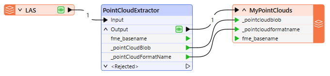

In this example, we will prepare and write a point cloud to a PostgreSQL database, which does not support geometry as an attribute type.
The point cloud feature is routed into a PointCloudExtractor, and then on to a PostgreSQL Writer.

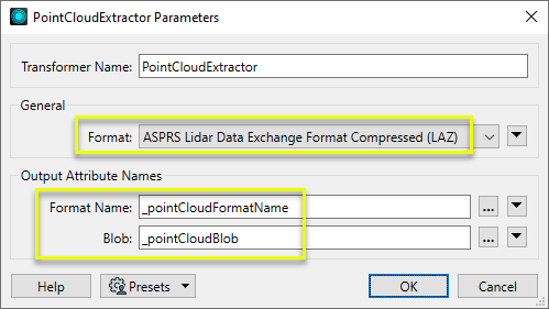

In the parameters dialog, Format is set to LAZ, and the Format Name and Blob attributes are left with the default names applied.

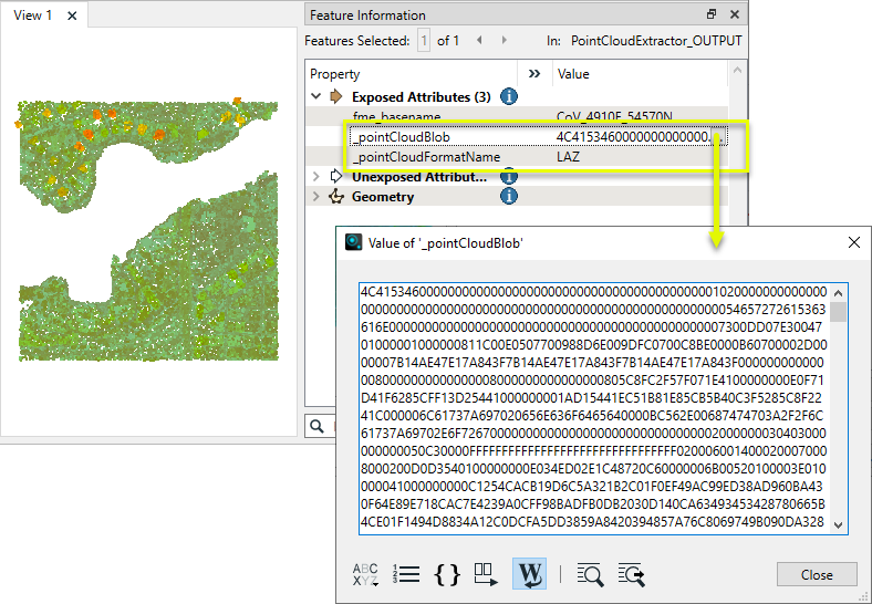

Examining the output from the PointCloudExtractor in the FME Data Inspector, note that the feature has two added attributes - _pointCloudBlob, containing the encoded point cloud, and _pointCloudFormatName, containing the name (LAZ) of the chosen encoding.
