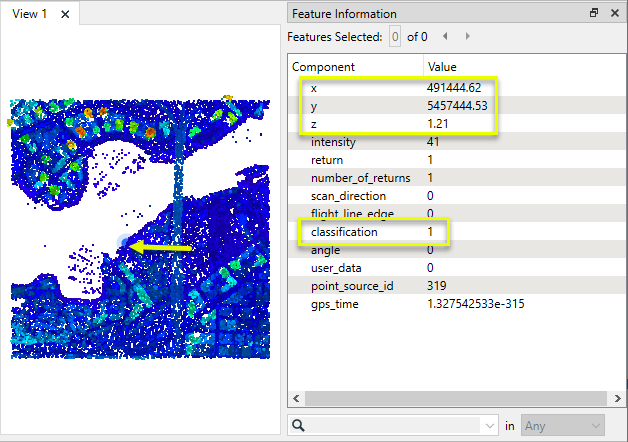

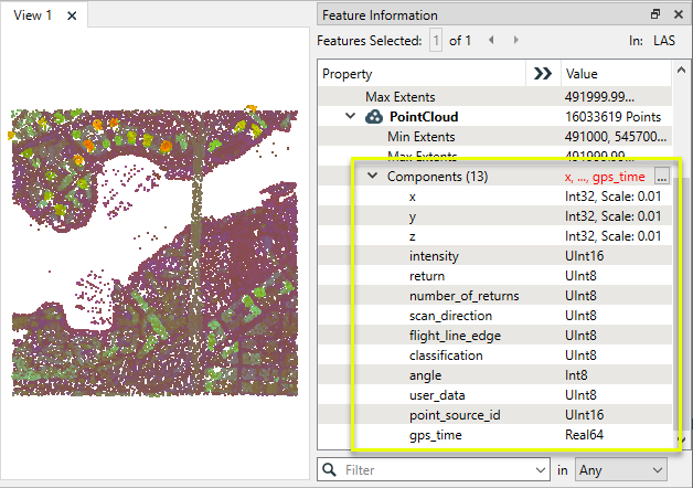

Note that the original point cloud has thirteen components.
Each point in the point cloud has values for each component. The four components we wish to keep are outlined in yellow.

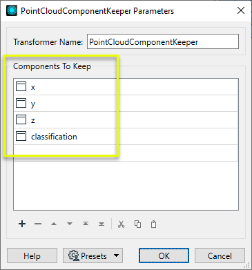

The point cloud is routed into a PointCloudComponentKeeper.
In the parameters dialog, all required components are added to the Components to Keep table.

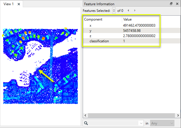

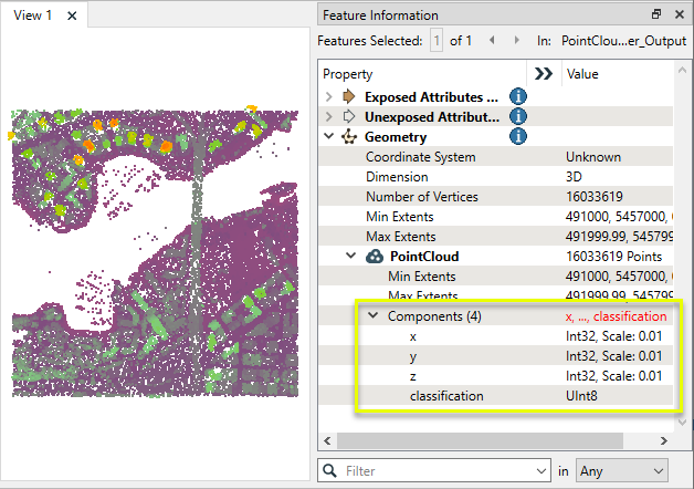

The output point cloud now has only four components.
The points no longer have unneeded components and values. Note that the removal of the intensity component has resulted in a slight difference in how the FME Data Inspector displays the point cloud color ramp.
