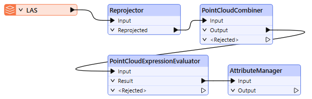

In this example, we are building a point cloud processing workspace.
The source datasets are four LAS point clouds, totaling approximately 387 MB, which need to be reprojected, combined, have some component values calculated, and then be passed along for further processing.
As all of these operations will be accumulated until they are required (such as enter a writer), we cannot yet determine how long it might take to process this.
A run of the workspace as it stands is very fast, an indication that the point cloud operations have been held for later processing.

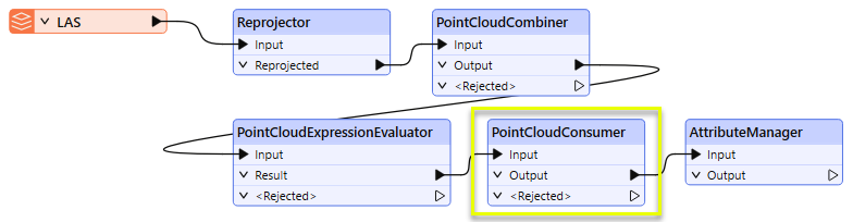

To get a more accurate idea of how long this will take, we add a PointCloudConsumer after the three point cloud processing transformers.

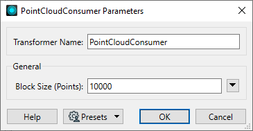

In the parameters dialog, we keep the default settings.
Running the workspace again, we can see that it will take more time to fully read and process the point clouds, with the accumulated operations applied.

Block Size (Points) |
The point cloud will be consumed in blocks, reading this many points in each block. Adjusting this parameter is generally only useful for internal Safe testing. |
