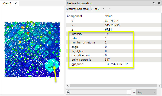

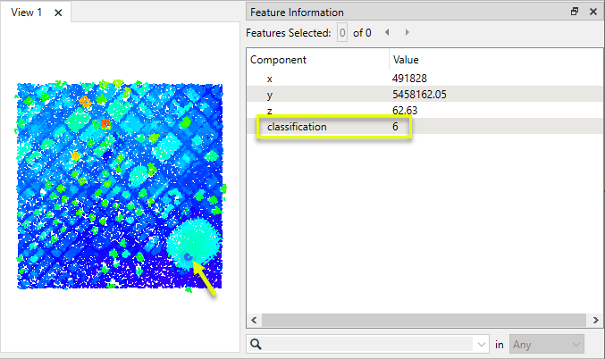

In this example, we have two co-located point clouds, each with a different set of components.
The first one has a selection of standard components, but does not have classification.
The second point cloud has a classification component.

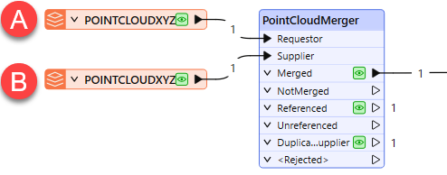

Both point clouds are routed into a PointCloudMerger. The first (A) is the Requestor, and the second (B) is the Supplier. Any components on B will be merged onto A.

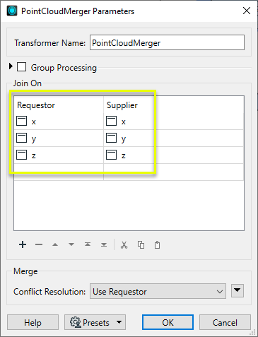

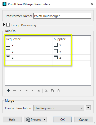

In the parameters dialog, a join is defined for the x, y, and z components, matching individual points on position only.

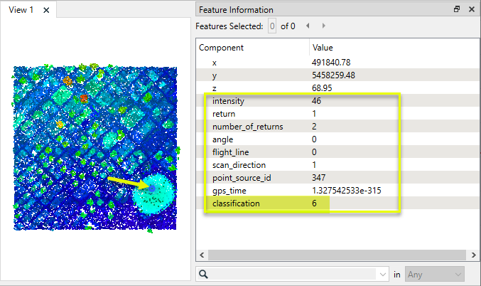

The point cloud output from the Merged port contains all points that found a positional match, and has components from both original point clouds.

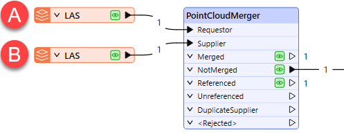

Both point clouds are routed into a PointCloudMerger. The original (A) is the Requestor, and the thinned point cloud (B) is the Supplier.
In the parameters dialog, a join is defined for the x, y, and z components, matching individual points on position.
The point cloud output from the Merged port will contain the points that existed both in the original and the thinned versions.
The point cloud output from the NotMerged port contains 13,035,567 points that were in the original and did not appear in the thinned version - therefore, they were deleted.

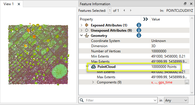

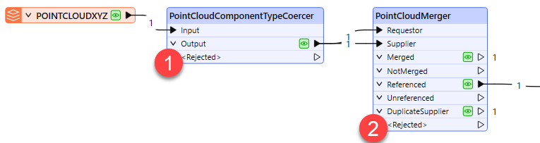

In this example, we have an XYZ point cloud of 10,000,000 points. The file is over 600 MB, and we want to reduce the complexity of it.
Note that the coordinates are floating-point values.
We will do this in two steps:

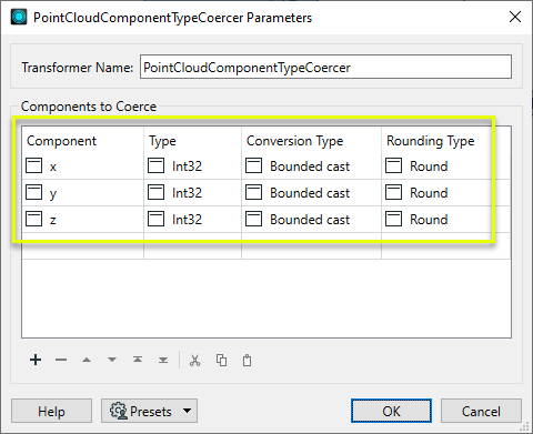

- Round the coordinate values by converting them from floating-point to integer using a PointCloudComponentTypeCoercer.
- Identify and discard the resulting duplicates with a PointCloudMerger.
In the parameters dialog of the PointCloudComponentTypeCoercer, the x, y, and z components are converted to type Int32 (32-bit integer), and rounded.

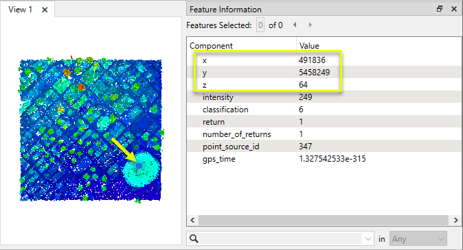

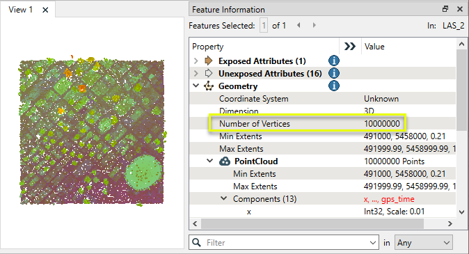

Note that the coordinate component values are now integers.
The point cloud is now routed into the PointCloudMerger as both the Supplier and the Requestor - effectively merging it with itself.

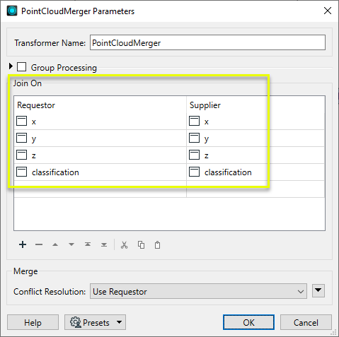

The coordinate rounding produced a large number of duplicated point positions. In the case where a location contains multiple points with different classification values, we want to keep one of each classification.
A join is created on the x, y, and z components for position, and classification is joined as well.

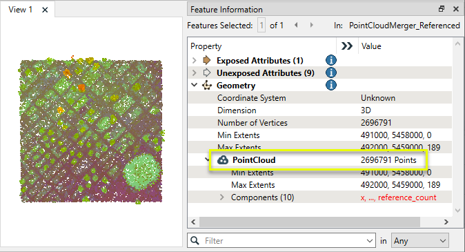

When a merge is performed, each unique Supplier point (with uniqueness determined by the combination of all defined Join On component values) is used only once. The first instance is output in the Referenced point cloud, and all duplicates are output in the DuplicateSupplier point cloud.
By merging the point cloud with a copy of itself, all unique Referenced points will be output exactly once - effectively stripping duplicates from the point cloud.
Note that the Referenced point cloud has 2,696,791 points - down from the original 10,000,000.
