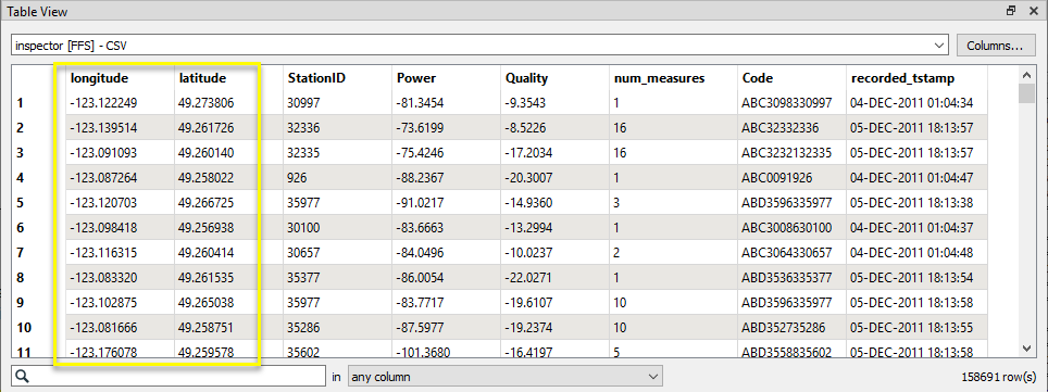

In this example, we are starting with a text file (CSV) of cell signal measurements. We want to convert the entire dataset to a single point cloud.
Note that coordinates are available in the longitude and latitude attributes, however, the data is non-spatial at this point.

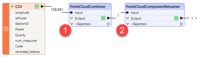

In order to treat the dataset as a point cloud and be able to perform spatial manipulations (such as reprojection), two steps are required.
First, the text records are routed into a PointCloudCombiner, where they are converted into a single point cloud feature.
Next, a PointCloudComponentRenamer is used to change the longitude and latitude values to x and y components - and so as individual point coordinates within the point cloud.

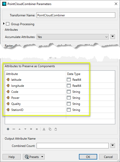

In the parameters dialog of the PointCloudCombiner, most of the input features’ attributes are kept by specifying them in the Attributes to Preserve as Components table. This will retain individual values on each point within the point cloud, including coordinates.

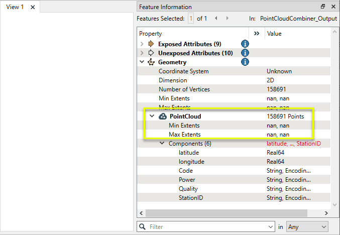

A single point cloud feature is output, but it does not yet have point geometries inside the point cloud. Note that the extents are nan, nan - meaning not a number.

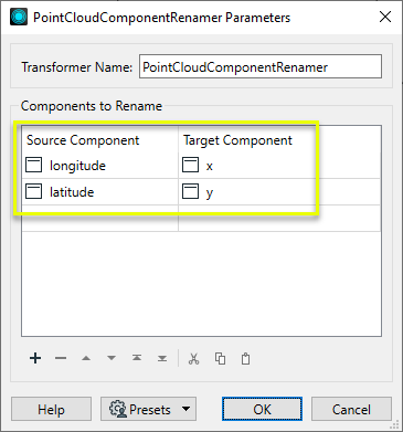

In the parameters dialog of the PointCloudComponentRenamer, we rename the longitude and latitude components to x and y - the standard coordinate component names.
Standard names are available on the Target Component’s drop-down menu.

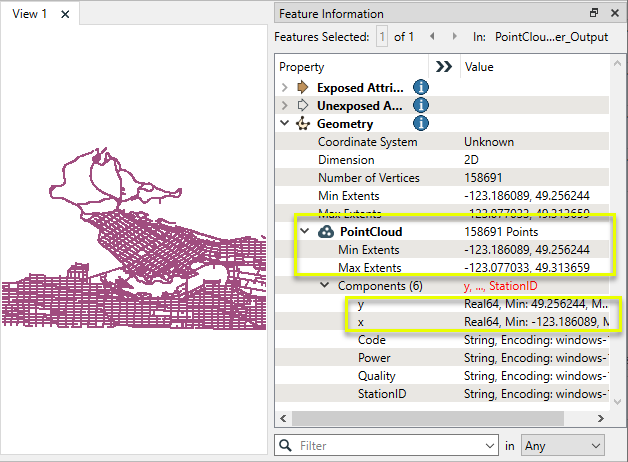

The output point cloud feature now contains points and has valid extents.
The original CSV text file is now a point cloud, and may be passed along for further processing. Note that it does not have a z component, which could be created and set to zero (0) if necessary with a PointCloudComponentAdder.
