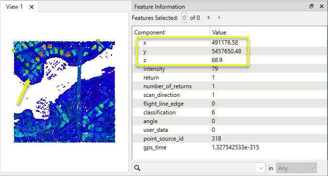

In this example, we want to create backup copies of the x, y, and z component values in a point cloud before performing manipulations on them.
Note that the source point cloud has x, y, and z components.

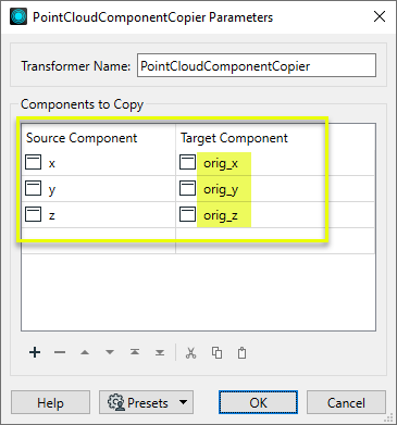

The point cloud is routed into a PointCloudComponentCopier.
In the parameters dialog, we make three entries in the Components to Copy table - one for each of x, y, and z. New component names are assigned in the Target Component column, which will be added as new components.

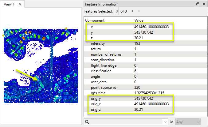

The output point cloud feature has three new components, containing a copy of the original components’ values, and is passed on into the workspace for further processing.
If desired, another PointCloudComponentCopier could be used after x,y, and z are manipulated - copying from the new orig_x, orig_y, and orig_z back onto x, y, and z - to restore the original values.
