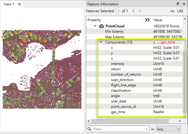

Note that the original point cloud has thirteen components.

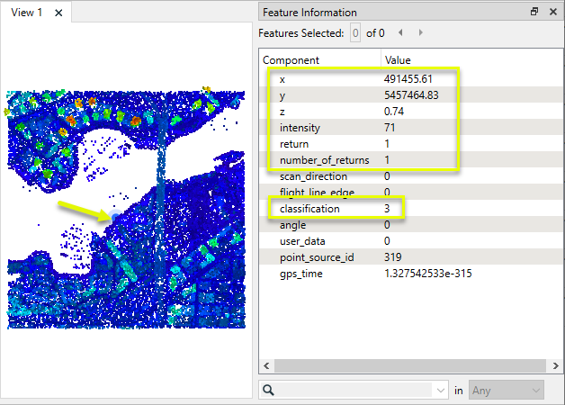

Each point in the point cloud has values for each component. The components we wish to keep are outlined in yellow.

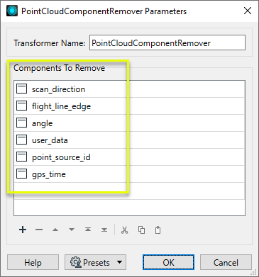

In the parameters dialog, all unneeded components are added to the Components to Remove table.

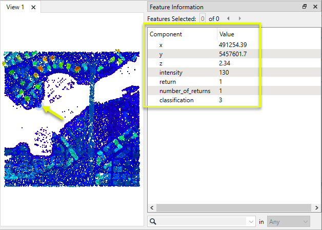

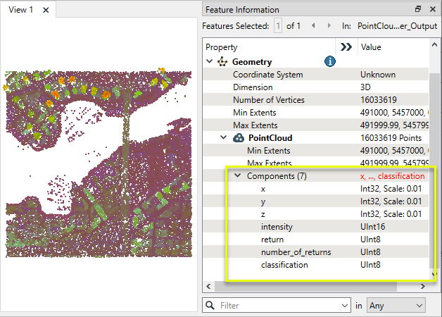

The output point cloud now has only 7 components.
The points no longer have unneeded components and values.
