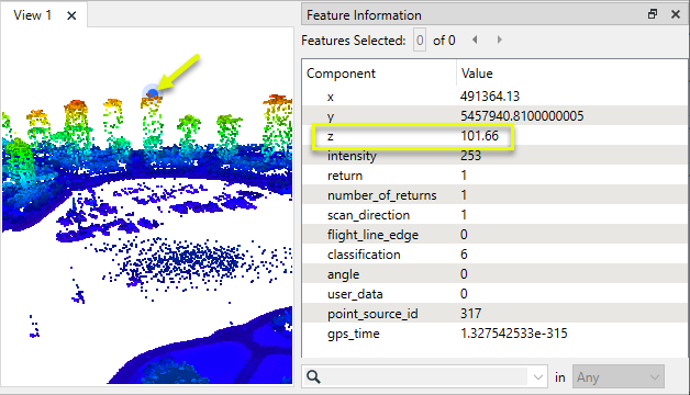

In this example, we will calculate above-ground-level (AGL) heights for a LiDAR point cloud, located on the coast, near sea level, with many tall buildings.

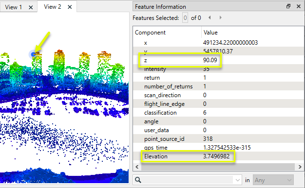

Note that the source feature, viewed here in the FME Data Inspector from an oblique angle in 3D, has a z component representing the elevation of the point - which is not necessarily the elevation of the ground. Points are returned above the ground when they encounter structures and vegetation.

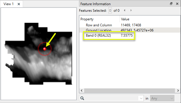

We will overlay the point cloud on a DEM elevation raster in order to extract the ground elevations. Note that the elevations are stored in Band 0 of this single-band raster. Both datasets are in the same coordinate system and units.

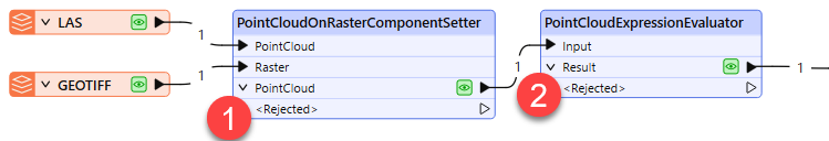

The operation will take two steps. First, both the point cloud and DEM raster are routed into a PointCloudOnRasterComponentSetter to extract the ground elevations. Then the resulting point cloud feature is sent on to the PointCloudExpressionEvaluator to calculate the AGL heights.

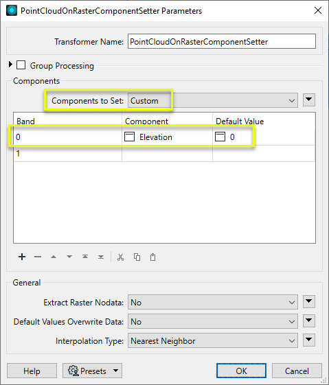

In the parameters dialog of the PointCloudOnRasterComponentSetter, we set Components to Set to Custom.
The custom component is defined in the Components table, extracting values from Band 0 to a new component named Elevation. The Default Value is set to 0.
Note that the output point cloud feature has a new component - Elevation. The selected point shown here has a z value of about 90 meters -but the ground elevation at that location is only about 3.75 meters.

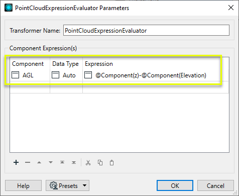

In the parameters dialog of the PointCloudExpressionEvaluator a new Component is defined, named AGL. The Data Type is set to Auto, and an expression is constructed that subtracts the ground elevation from the point elevation.

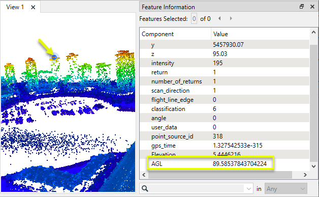

The output point cloud feature has a new AGL component with the results of the expression evaluation.
