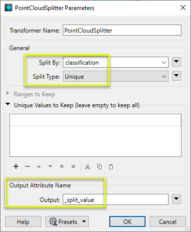

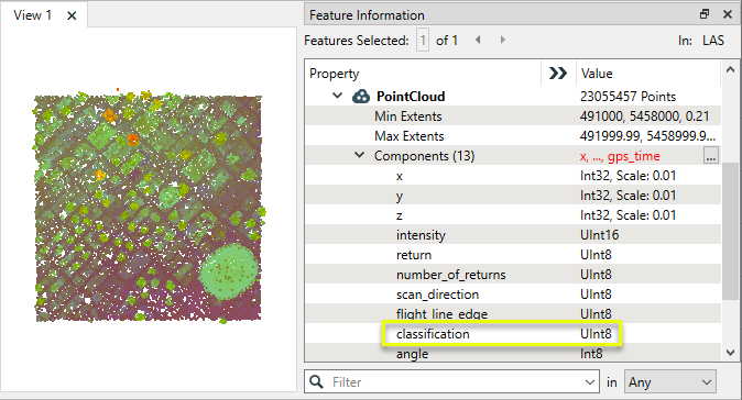

In this example, we will divide a point cloud into parts, based on its classification component values. Note that the input point cloud does have a classification component, but we do not know what exact values may exist in the feature.

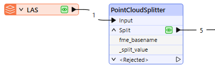

The point cloud is routed into a PointCloudSplitter.
In the parameters dialog, Split By is set to classification, and the Split Type is Unique. We keep the default Output attribute name of _split_value.
Note that Unique Values to Keep is empty - and so all values will be output.
Five features are output, indicating the five unique values were found for classification in the input point cloud. Examining the Split output in the FME Data Inspector’s table view, we can see those values assigned to the _split_value attribute.

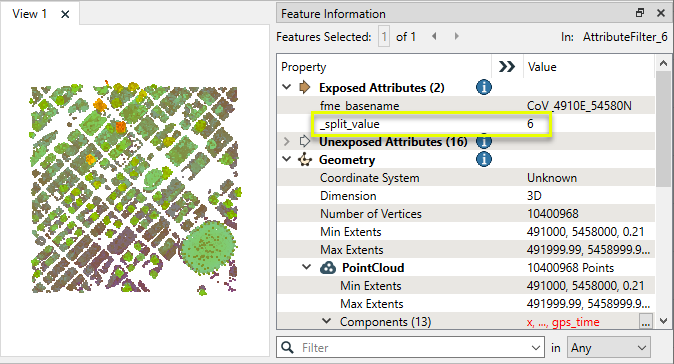

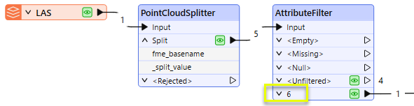

To examine one of these features, we further route them through an AttributeFilter, filtering on _split_value, and looking only for value 6 (buildings).
This output point cloud contains all points from the original that had a classification value of 6, indicated by its _split_value attribute.
