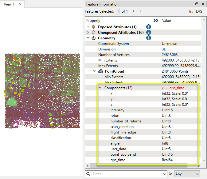

In this example, we will calculate some statistics on a LiDAR point cloud. The source data has a number of components that we may use.

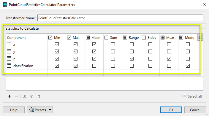

In the parameters dialog, we select the components of interest and choose which statistics are to be calculated for each one.

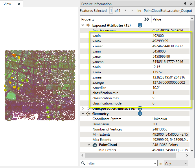

The output feature has new attributes containing the requested statistics. Note that the attribute names are composed of the component name and statistic type.
