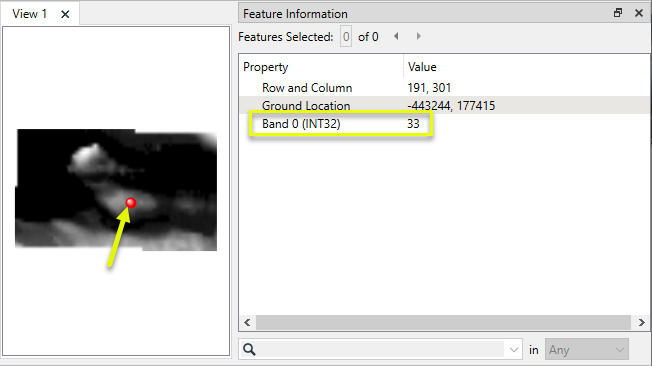

In this example, we will vectorize a DEM dataset. The original data is represented as a single band numeric raster. The band values represent elevation in meters.

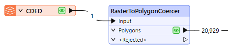

The raster is routed into a RasterToPolygonCoercer.

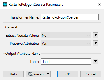

In the parameters dialog, we keep the default settings - discarding Nodata values, preserving attributes, and creating a new Label attribute which will contain the band values.

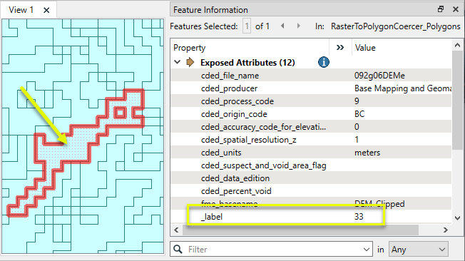

Polygons are produced, surrounding areas with identical band values. Donuts are produced where necessary. Note the new _label attribute, with the band value.

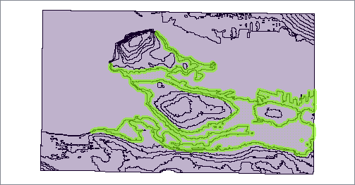

In this source data, the elevation intervals are one meter, producing a large number of small polygons. These polygons can be grouped together and dissolved, using an AttributeRangeMapper and a Dissolver to produce generalized polygons, as shown. The ranges used here are 10 meters each.
