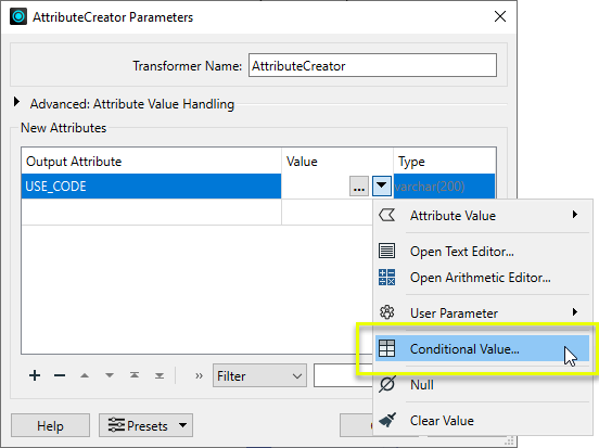

In many transformers and writers, attribute values can be set conditionally - that is, different values are assigned based on whether or not specified conditions are met.
As shown here in an AttributeCreator transformer, if Conditional Value... appears on the context menu when setting a value, conditionals are available.

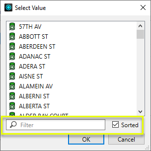

As shown here in the Tester, if the Left Value has been set to an Attribute Value and the features have been cached, the context menu provides access to the values available in those features. If there are only a few choices, they will be presented in a sub-menu.
If there are a large number of choices, the values will be presented in a Select Value dialog, where the values may be sorted and searched with the Filter option.

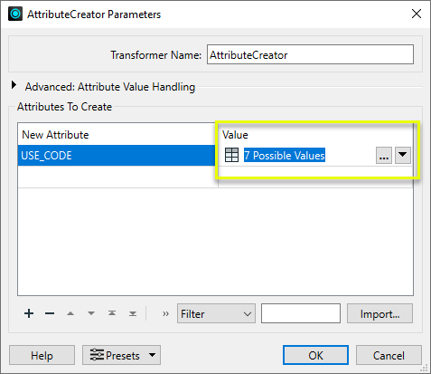

In this example, we will create one new attribute, and assign its value based on another value. The original data contains streets with two attributes. They are routed into an AttributeCreator.
In the parameters dialog, conditional values have been defined, indicated by 7 Possible Values. We can review them via the ellipsis button or the context menu.

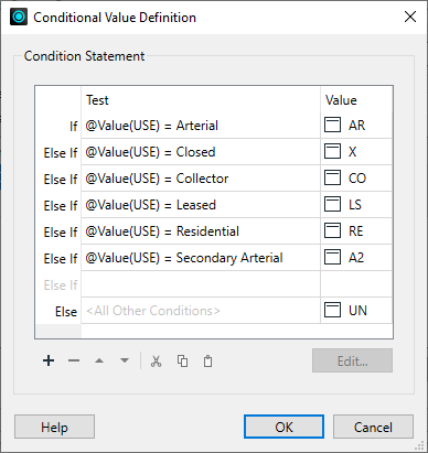

Six Test Conditions have been created, assigning a code to the new attribute USE_CODE, based on the value of the existing attribute USE. If a USE value is found that does match any of these tests, it will receive the USE_CODE value UN.

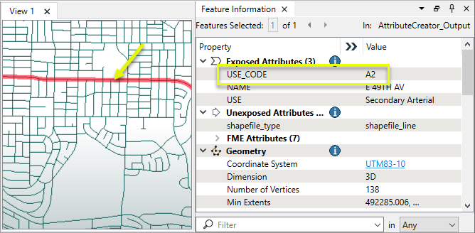

The output features now have conditionally assigned values for the new attribute USE_CODE.
