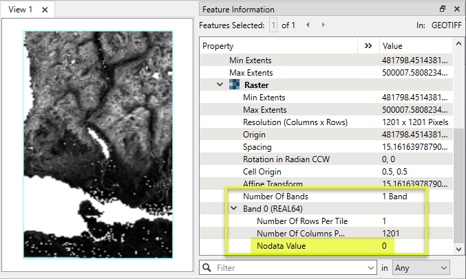

In this example, we want to remove the Nodata value from a numeric raster that contains slope values calculated from an elevation model.
Note that the source raster has one band, and its Nodata Value is zero (0). As a result, cells with no slope (value of zero) are not displayed, making flat surfaces such as water bodies transparent.

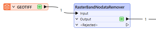

The raster feature is routed into a RasterBandNodataRemover.

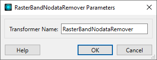

The transformer has no parameters to configure.
