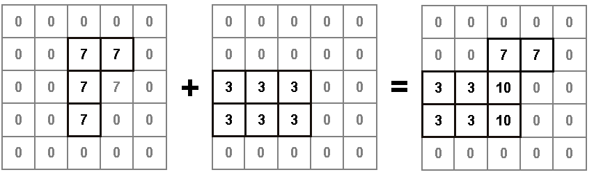

The rasters are routed into A and B input ports, and an Operation is selected to perform, constructing a basic expression in the form A <operation> B. Operations available include addition, subtraction, multiplication, division, and three basic statistics - minimum, maximum, and average. The order of A and B is fixed, and matters for certain operations including division and subtraction.

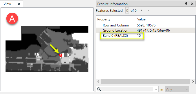

We start with two numeric rasters. The first represents zoning, with integer values ranging from 1 to 10, where each value arbitrarily represents a zone type. The selected pixel here, with a value of 10, is zoned Industrial This will be our “A” raster.

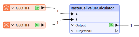

The pair of rasters is routed into a RasterCellValueCalculator.

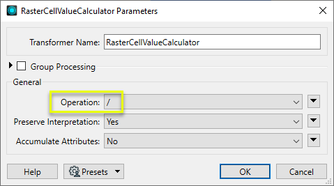

In the parameters dialog, the Operation is set to “/” - division. This will perform A / B, and so the zone values (from 1 to 10) will be divided by either 0 or 1.

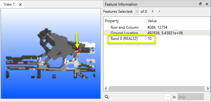

Cells that fall within a buffer retain their original value (being divided by 1). Cells that fall outside the buffer fail to be divided by 0 - and so become “Nodata” values. The output raster feature is shown here over a blue background to show the Nodata areas clearly.
