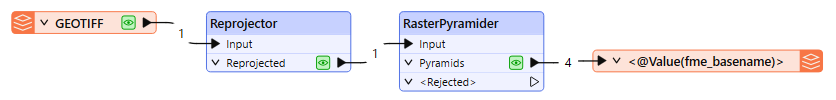

Here, we start with a 2 Gb GeoTIFF source raster, which needs to be reprojected, then pyramided, and finally written with a GeoTIFF writer.

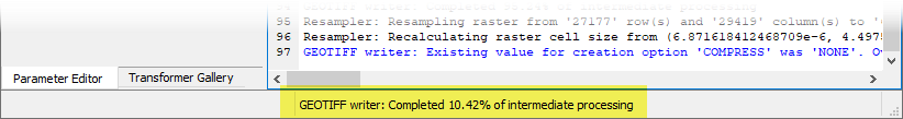

The writer is where both the reprojection and pyramiding operations occur, as can be observed in the status bar while the workspace is running.
The workspace takes over four minutes to run.

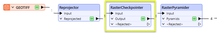

The workspace is modified, adding a RasterCheckpointer between the Reprojector and the RasterPyramider.
The RasterCheckpointer has no parameters to configure.
In this scenario, the reprojection operation takes place in the RasterCheckpointer, is written to disk, and then the pyramiding takes place in the GeoTIFF writer.
Upon running the workspace, the processing time is substantially reduced.
Though RasterCheckpointers are not generally necessary, this specific combination of one very large input raster and two computationally-intensive transformers benefits from using one.
